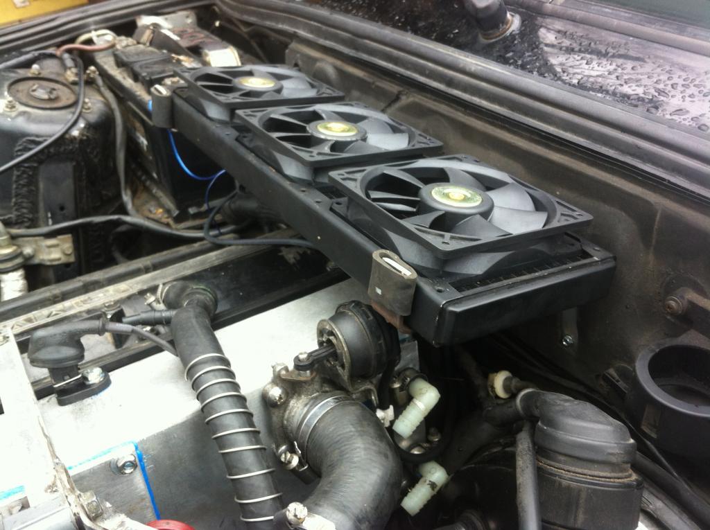

        O2 is here, I ordered a lc1, got a lc2. I hear there is pretty much no difference. I'm working on the aftercooler's external heat exchanger at the moment. Just got all three fans mounted to the exchanger and wired to each other. Damn folks, it's almost time. I'm nervous.

                  Sorry to tell ya.. But I seriously doubt those fans will be doing anything. Best bet for lowering temps is gonna be meth.

                      But I have to disagree. To say that you doubt that they will do anything, is kinda silly. How could those fans not be doing something? They blow a shitload of air through that radiator. The S/C is gonna blow a shit load of air across the identical radiator inside the manifold. There is going to be an opening in the hood directly above with a scoop for forced fresh air across it while cruising. Plus, those fans are only really to help while the car is stopped.

                        Intercoolers are usually set up in front of the radiator, not behind it.
                        Subaru sets up their stock intercoolers there, fed by a scoop, but most high powered Subie guys go for a FMIC.

                          Cfm rating on those fans is minimal. I've been a comp tech for years, only decent Cfm is 120-220v fans at that size. I've also built many water cooled pcs my last one used a car transmission cooler for passive cooling. Might want to look into something like that mounted far from the engine bay to minimize soak. I just can't see them blowing enough air to make a substantial difference.
                          Not doubting the build but I think you're going to have to change a few things to make it work better, at least consistently in terms of being able to beat on it for awhile without heat soaking killing things.
                          My turbo car gets crazy heat soak after runs, I've got massive holes in my hood, wide open intercooler and completely new cooling system, everything is heat wrapped and it's still becomes an issue if I keep things up for more then 3-4 runs on the track, but this is literally bouncing off the limiter, headers glowing, turbo glowing.

                            You are going to get better air flow at the front of the car versus trying to make a scoop.
                            Theres a reason why the hood scoop are so massive on stis.

                              But fellas, this is not a track car. It's a relatively low powered daily driver. I think the tendency is to think I'm trying to milk every last ounce of power out of this. I'm not. I'm just building shit that I think is cool. That's what gets me high. Not making eleventy billion HP.

                                I think FLG and I will both agree the cooler you can get this setup to run the better it will be for Daily driving, even at low boost super charger still get hot.
                                Not trying to tear apart your ideas, just suggestions.
