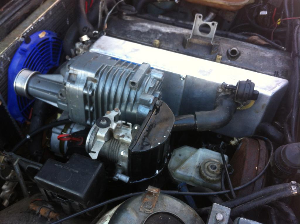

        Stupid me question, will enough air fit in there, and any issue being centered on Cyl #1 for flow to the rest of the cylinders?
            I don't think that's a stupid question. Mainly because I've wondered the same things. I've talked myself out of the possibility of either of them becoming a problem. All of the air does come in above 1 & 2, but i think the whole manifold will be pressurized and the air will just go where it can fit. And about enough air fitting, there is no smaller opening leading up to the s/c intake than the s/c intake itself. Idk if I said that right…

              Crossed my mind as well. But we'll see
              Op, whats going on in the other pic... I'm. A bit confused. Sorry, confused turbo guy here.

                The throttle body didn't have enough room behind the s/c where the inlet is. So I had to make a u-turn. The thing that is connected to the u-turn is the by-pass valve. It releases the manifold pressure to the inlet when the throttle plate is closed (or largely closed). It is a cousin to a blow-off valve, but it keeps the air inside the system.
                  Thats right, the way I understand it. Designwise, it looks not unlike factory OEM boosted setups.

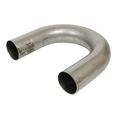

                      I know you've already done it, but I was thinking, if you came out in a tube, the same size as the TB, you could come back further, and straighten out the airflow, and make enough room to fit your air metering device, and air filter before getting into interference with the supercharger drive belt.
                      • Ether-D
                        • Sep 2011
                        • 2838
                        #116
                        I don't think I follow, Farbin. The drive belt for the s/c is out of the way. Whatchutalkinbout?
                          OK, I was saying, instead of your black box doodad to connect the TB to the S/C intake, mount a mandrel bend, or series of mandrel bends to actually move the TB back further, above the M/C, and thus allowing room for your AFM/HFM/whatev you end up with, AND your air filter, so it is all behind the belt line, so to speak. Being as you are parallel to the S/C body, and tight with the TB, all the other stuff will be close as well. and you are already at the front of the engine bay.
                          Plus, since I am not modeling the flow, just spitballin' but the tightness can hamper flow, right?
                          • Ether-D
                            • Sep 2011
                            • 2838
                            #118
                            Oh, like the tube would come straight back out of the s/c inlet and turn down and then back forward and up? That would work too I think. The reason I did it this way was materials on-hand, and I needed room for the by-pass valve to mount to the manifold.

                              Pretty much, you got the idea.
