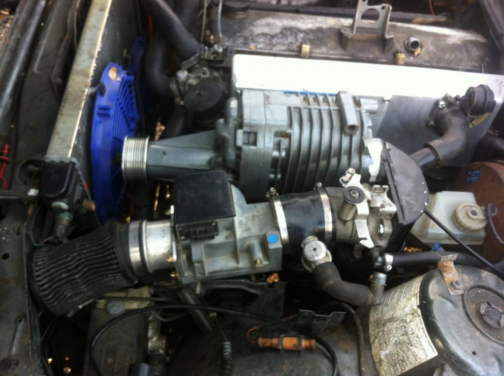

      Today's progress
      I got my coupler in the mail to attach the airflometer to the TB and get the ICV in to the mix. $9. I wish I could go ahead and do the MAF swap, but I'm on a pretty good spending freeze right now. So, airflometer it is for the time being.
      BTdubz, don't be jealous of my sweet 20 year old crunched K&N, it came with the beater.
      Originally posted by Andy.B
      Whenever I am about to make a particularly questionable decision regarding a worryingly cheap diy solution, I just ask myself, "What would Ether-D do?"

          Part 2:
          Once I get the airflometer changed to a massairflometer, it'll be neato.
