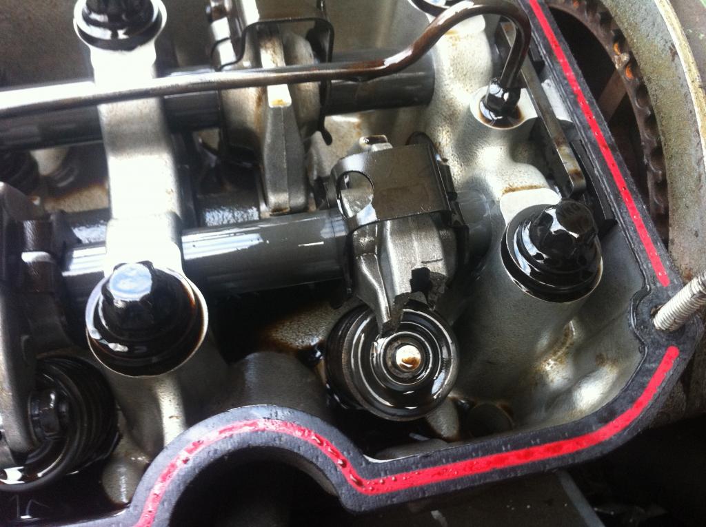

                Then about 50 miles later, this happened…
                motherfuckshitballsucker!!!!!!

                  Thanks bro. That's what I was shooting for. I don't reckon it'll be down for too long, as I have the extra car. But still, fuck.

                    #444
                    Just spent an hour reading this thread. Nice build and that last pic equals ouch!!
                    Time for a set of beefier rocker arms?
                      I think so. Those were a mix of used ones from 3 different heads.

                        #446
                        Might want to further investigate. I'm on stock rockers at 330whp (soon to be 400 :-) )

                            #448
                            Sent from my SCH-I545 using Tapatalk 2
                            I think it was just weak and old. I'm gonna get a full set of new ones.

                              #449
                              Oops... Yeah, weak and old is probably the culprit, as long as you had lash set correctly.
                              Horsepower or even RPM doesn't kill rocker arms... valve spring load and cam lobe ramp rates do. If you're on stock valvesprings and a stock cam, just replace it with a stocker.
                              HOWEVER, you may consider a NEW stocker instead of another part with an unknown history. Febi rockers for my M30 were reasonably priced, but I don't remember the exact amount right off.

                                #450
                                I was nearly 400hp with stock rockers, I have my old head which is minty 115k if you are interested. Will be selling soon. I would get hd rockers regardless if you rebuild it, they are not that much for peace of mind.
