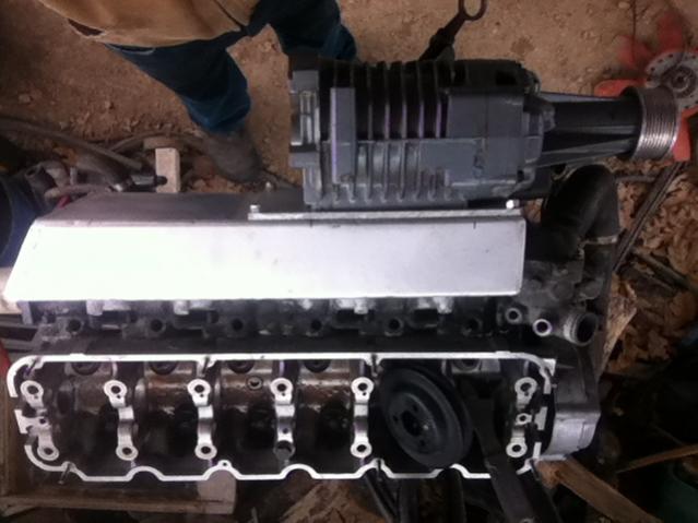

          #64
          I like! Will the intake clear the brake booster? Also you going serpentine belt or?

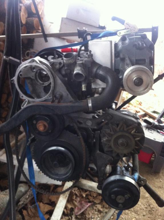

            #65
            It clears, barely. That was part of the reason the backside is bevelled. My goal was to use the simplest and cleanest, most OE sorta way I could come up with. Right now I'm using a multi-rib belt (serpentine?) on the power steering loop. That's also the loop that the charger is on (now). It's kinda ridiculously simple. There is a water to air intercooler being built into the manifold as well.

            • Farbin Kaiber
              Lil' Puppet
              • 29502
              #66
              So, this setup clears the booter, retains P/S & A/C? AND, runs an m90 instead of an m6x by resolving the snout length? Extra like.

                • Farbin Kaiber
                  Lil' Puppet
                  • 29502
                  #68
                  wait, AND WILL BE WATEEEER TO AIR?

                      I was born on 3/25…
                      • TheTacoMan
                        • Nov 2011
                        • 2308
                        #71
                        This is the right way to do superchargers. I like this.
