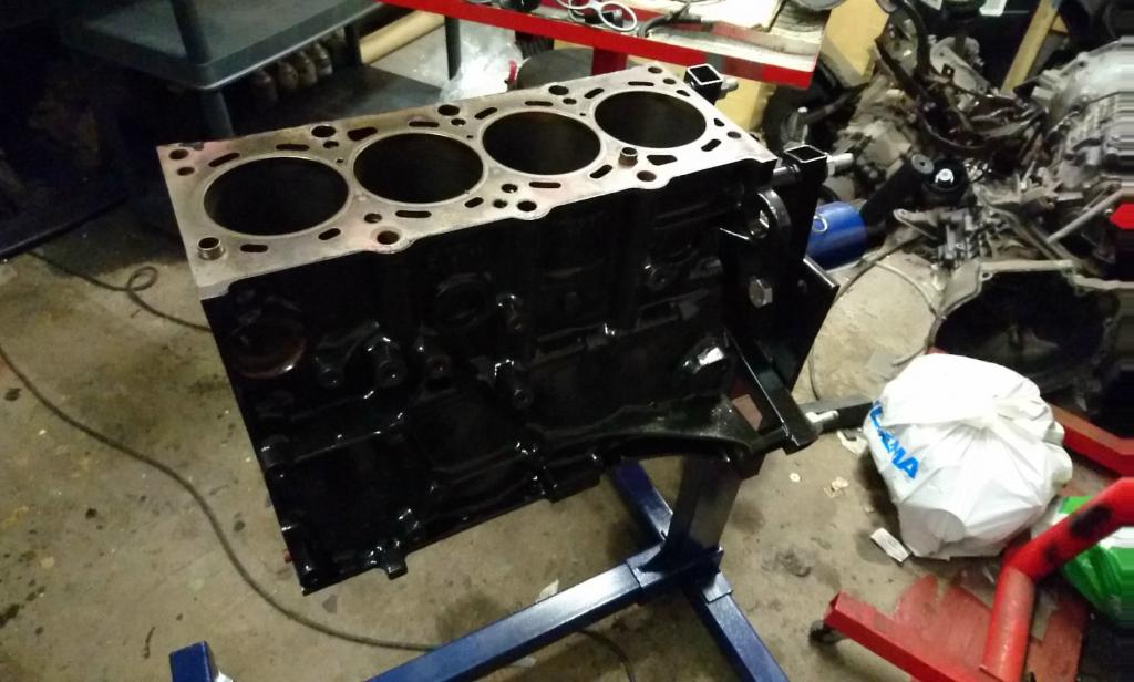

    Hello from Norway. Here I will keep some kind of log/build thread of my forced induction project. M42 turbo!
    I chose the M42 because of the weight, weightdistribution and the potential.
    The goal is around 400-450whp.
    The parts I am going to use is:
    - Stock M42 block with o-rings in the block. M50 crankbearings, and new bearings/gaskets on the whole engine.

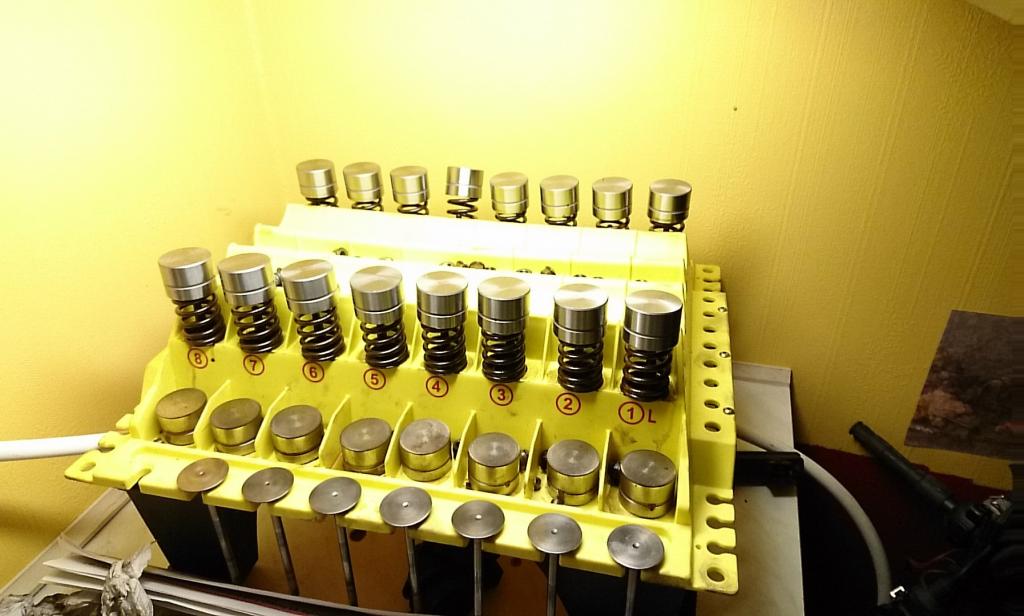

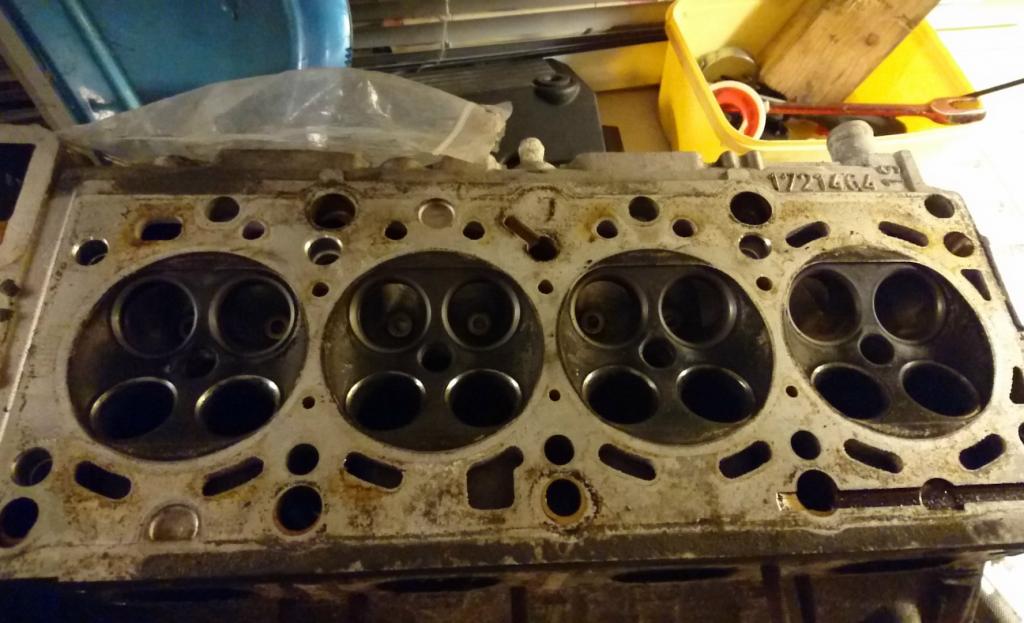

    - M42 head with grinded valves, ported intake/exhaust canals, with reinforced M50 valve-springs, stock headgasket, VAG lifters and custom camshafts by KMcams. I am thinking about a revlimit on 7500rpm.
    - Lathed pistons down to 7.3:1 compression
    - M20 flywheel, with 618-pressureplate and Sachs raceplate, springless.
    - VEMS standalone ECU with Electromotive singlecoils.
    - Garrett T3/T4e, 50trim turbo
    - E36 325i aluminum radiator
    Thats all I can think of at the moment. Pictures will come soon.
    The engine has been disassembled and the block has been painted. After it has been o-ringed I am going to hone it.
    At the moment I am calculating how much the pistons has to be lathed to lower the compession down to 7.3:1. The engine has to handle around 36-38psi of boost.
    You guys can ask me questions in this thread if you want, and I'll try to answer as best as I can.

                      Interested in seeing the m50 valve springs and VAG lifters for more r3vs! Might be interested in doing that myself in the future.

                            As the M42 is basicly an M50 with two cylinders less, it should work just fine. I am buying a set of little stiffer, double springs from M50.
