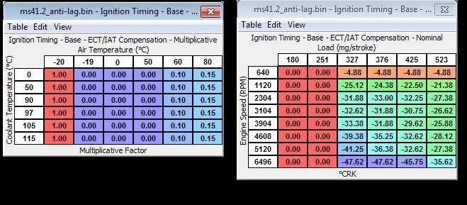

    Thought i'd post this here in-case anyone is interested in giving this a try, taken from my build thread in my sig. Applies to OBD2 only
    Fairly simple implementation:
    1. Cut the grey wire going to the IAT
    2. Relay wiring
    Pin 30 - connect to the grey IAT wire that is still connected to the ECU.
    Pin 87a - connect to the grey IAT wire that is still connected to the IAT sensor.
    Pin 85 - connect to a ground wire with a switch in it.
    Pin 86 - connect to any red/white wire for 12v.
    Pin 87 - connect a 60k ohm resistor and then wire tap this into the grey/brown IAT sensor wire.
    What this will do is intercept the IAT sensor reading and send a -25c temperature reading to the ECU.
    Then you just need to adjust the flash so that your correction tables will retard timing when the IAT sensor is -25c. I like to aim for -10 degrees of timing. The values in the attachment should target that for a stock ms41.2 rom (obviously this will be different once you're boosted).
    I haven't tested this on a running car, however was testing in the garage while logging and on ACC and confirmed that i didn't throw any CELs.

          I'm still wondering if we could just use the ASC timing retard table to do this (mostly would just avoid modifying maps that are used, and remove the need to splice IAT wire)

                  Good idea to trick the ECU into a map not normally used. I was JUST thinking about anti-lag on Motronic 1.3, but was going about it a different way by using a momentary switch with a 512 chip and 2 .bin files to do so - or using the WOT switch map with a momentary and disabling the TPS function (which I do anyways to keep the ECU in part throttle maps).

                        Apologies, my window was open and not refreshed for the long post npavlo. Very interesting since I was just discussing a vendor account with Jason at VEMS USA.
                        You are one of the few with a functional wing, although not sure why you would need 700lb downforce in an e30, the drag would out weigh the benefits for most applications, but the comment was more geared towards the reason it was made by the op. 700lb down force would destroy my lap times, not help them in any way ~175whp still barely pegs the inaccurate speedometer in a 2500lb brick - it reaches terminal velocity closer to 125 via GPS.
                        Just like 10yrs ago when forum members would bash me for tuning the stock e30 ECU and hacking it to do what I want, instead of using MS put a bad taste in my mouth. Instead of letting one offer information, instantly, it's said "you should have done this instead". Can't tell you how many "just 24v it" posts came up in the m20 sub forums when m50 swaps started to become popular.
                        Sometimes, it's not bout shooting flames, and some of us actually do use stock ECU's to do things they were never intended, and that doesn't make it "ghetto". My e36 ITB uses a 413 converted to Alpha-N and drive/runs/starts like stock and did so with a few hours of tuning - something that was unheard of a handful of years ago.
                        Either way, these posts are not constructive to the OP's findings IMO, take it with a grain of salt.

                              I've done something similar with megasquirt when spare inputs were not available to trigger it. It's of the same vein as slapping in 0 degrees of ignition advance in a very low MAP row of the ignition table for crackle on overrun. I call it "stupid tuner tricks" as a tongue in cheek reference to the response it would get out of someone who can afford a $4,000 professional grade engine management system.
