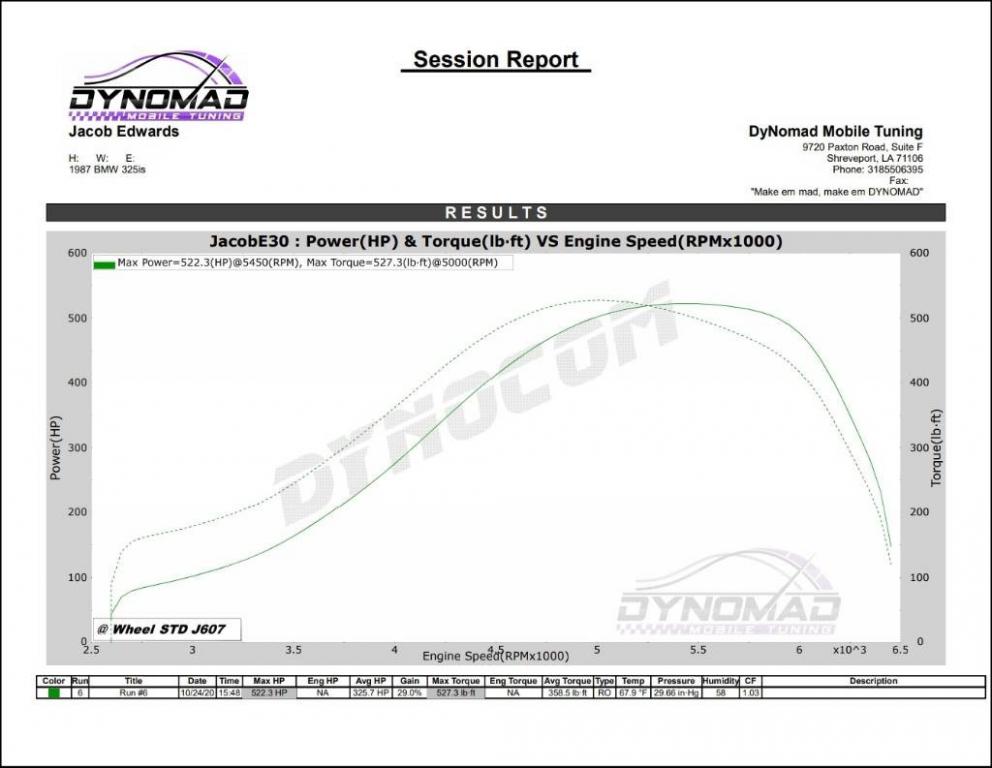

                        I did dyno my stock 2.7 bottom with 885 head before I pulled it out to go 2JZ + DCT swap. Head used a 280/274 bimmerheads cam.
                        21psi on E85, made 522whp

                          Big power. That was with the 6266? Where was full boost, 5,000rpm?

                            Great numbers .. I’d like to also know where the powerband was
                              Sorry for late reply, I rarely get on here. I just finished up my 2JZ with M4 DCT swap and am about to post a build thread on it.
                              This was a 0.81ar T4 6266. Full boost on the log was around 4500rpm.
