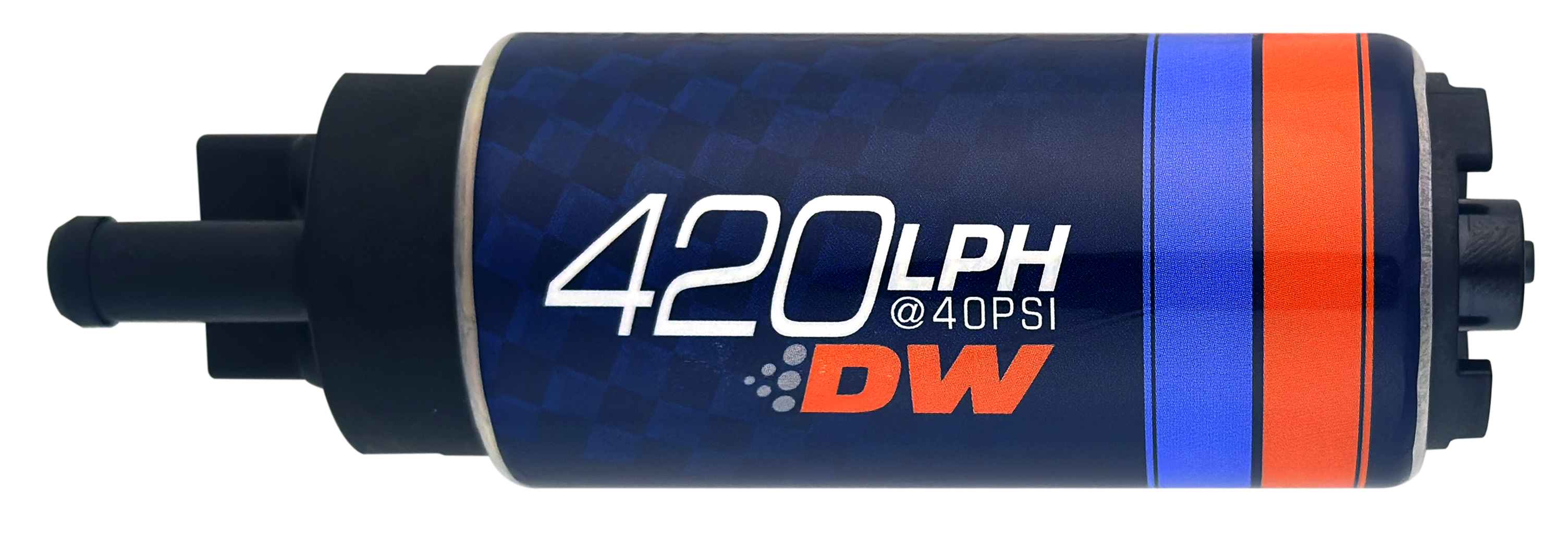

    DW
    Upgrade with DeatschWerks' high-performance fuel injectors, pumps, regulators, lines and fittings. Engineered for 400–2200 HP, built for racers and tuners worldwide.

                      Originally posted by Blake B
                      First post, best post. I like Deatsch pumps too. I'll echo the sentiments of the other posters in this thread, they should not be burning up like this and the question is, is there something wrong with your setup or are the pumps knockoffs?

                          I just installed an Aeromotive 340 for my S54 (way overkill, I just wanted something good quality). I think DW is a good choice as well. I specifically avoided Walbro because it seems impossible to know if you are getting a legitimate one or not. Is there any chance that you may have had fuel starvation that caused the pump to run dry?
                          Is there a DW pump that fits nicely in the E30 hanger? I had to chop off the bottom bracket for my Aeromotive, so it is just hanging there by the hose right now.
