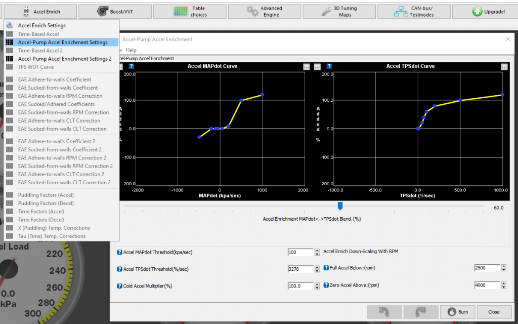

                  It looks like you have MAP decel enrichment taking out 10% of fuel when you have this issue? That's my best guess, anyway. The quickest fix would be to be sure that the MAP dot AE line (pictured below) doesn't go below 0% (e.g., the left-most blue dot on the left graph)
                  Alternatively, you can move the slider under the two graphs all the way to the right to select TPS dot AE only. Click image for larger version  Name:	AE settings.PNG Views:	0 Size:	292.7 KB ID:	10036777

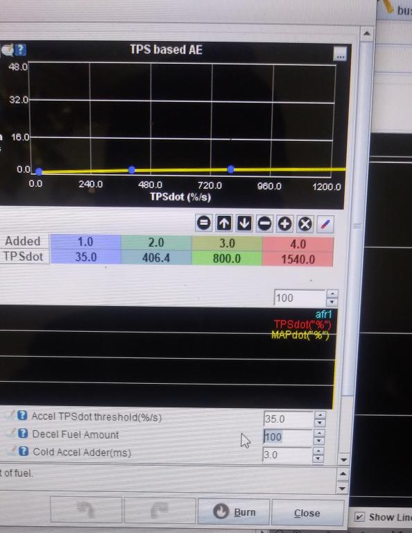

                    I'm having trouble finding that exact graph. I did find decel fuel cut set to 90% under tps based ae. Click image for larger version
                    • turbski
                      • Jul 2018
                      • 329
                      And you will have to excuse my ignorance but please explain how this setting has effect on performance? Or what it actually does

                        My apologies, you're on MS2, my screenshot is from MS3. I think you corrected the right setting.
                        The idea of acceleration enrichment or decel enleanment is to correct for transients that are too quick to be captured by, for example, the MAP sensor alone. You can think of this as supplementing the base fuel map with additional fuel when moving through the map rather than "steady state." What I understand is really happening is supplementing puddle of fuel on the intake port to reach equilibrium while supplying also enough fuel for the engine to accelerate.
                        Acceleration enrichment is adding fuel on top of the base fuel map to ensure the engine has enough fuel for acceleration.
                        Deceleration enleanment is removing fuel from the base table when the engine is decelerating. This is mostly to prevent extra fuel being thrown into the exhaust and aid fuel economy. In some conditions, the accel or decel settings are too aggressive and kick in during regular driving, which can lead to stumbles.
                        You'll see OEM cars puff a black plume out the exhaust when accelerating hard, often this a side effect of unburned fuel in the exhaust because of the aggressive AE.
                        Here's a video on tuning AE with megasquirt if you are curious, just to understand a little more of what is happening. (Opposite theory applies for DE, but isn't as critical to a well-driving car)
