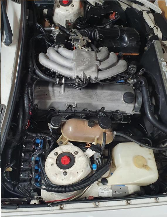

      I put a bit of aluminium pipe pipe to replace the AFM, 2.75" as posted above. cheap as for a lenght. cut it to size and just slide it in where the AFM was.
      Here is a poor photo of my engine bay showing the pipe,
      https://www.r3vlimited.com/board/fil...3&d=1647387175
      Then I got a GM IAT from at the wreckers that was in the airbox on that car. I drilled a hole in the bmw airbox and just glued the IAT to the side of the airbox, been there for years.
      It was one of these IATs came off a holden commodore here, just glued it to the e30 airbox. If i was doing a turbo car id put it in the intake pipe, but for NA i see no issue with it in the airbox.
