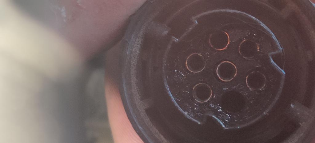

        Thinking this may be a fuel injector issue, I traced down all ways injectors get power, is this normal? Or am I missing pin 5? I seem to get some voltage when I put my volt meter, however not a very good contact?
        • completelyrevlimited
          • Oct 2022
          • 31
          Sorry had to compress the picture, the black looking stuff is Dielectric grease* assumed it would help if corrosion arrises
          Edit: Researched it more thoroughly, 87 may or may not have it, and seems like 88 onward has it built into the harness itself
