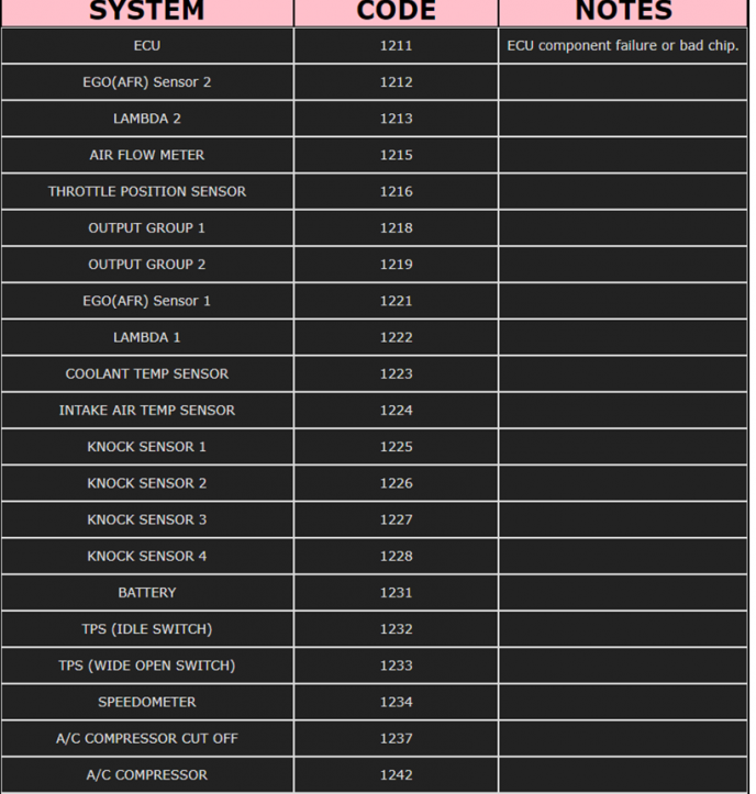

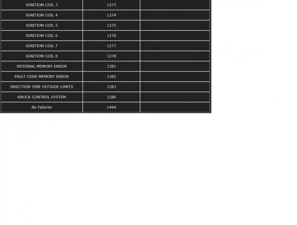

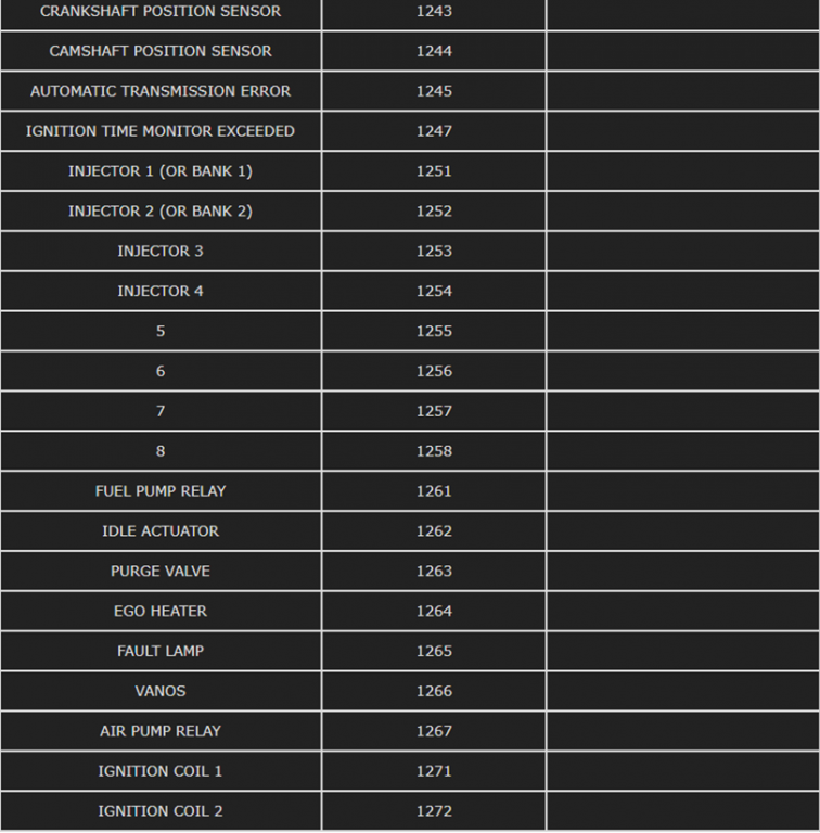

                  Here is a list of the codes
ID:	10071827 Click image for larger version
ID:	10071828 Click image for larger version
