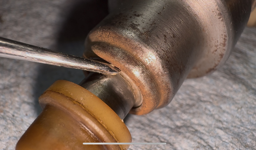

                    I took the injectors back out to do some more inspecting. When I apply 4psi to 5 of the injectors, they do not leak. Cylinder 1 however does, but not where I expected. I thought it was sticking open but that isn't the case. The needle valve is closing and sealing as it should. But the injector is actually leaking along the seam where the nozzle shaft comes out of the body. So it's spraying fuel outside of the o-ring completely.

                      FiveO Motorsports will sell you 6 new updated genuine Bosch Units
                      @Zakspeed_US
                      • PEZ2
                        • 50
                        2nd FivoO Motorsports. They have ā€œeā€ injectors at a reasonable price.
