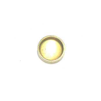

    Just a word of caution, do not use febi Welch plugs when rebuilding your engine. I built this stroker a while ago and used Febi plugs ($1 vs $10/each for OEM). One started to drip so I pulled it out, found why it was leaking (defect in the plug edge that no loctite 540 could seal) and ordered a set of six new plugs. Well looks like all 6 are of a terrible quality. Like all are messed up like the one I pulled but worse, Febi is probably having China make these anymore.
    Replacing core plugs while the engine is installed and everything bolted isn't fun job.
    So it looks like only two choices are left for these M20s, OEM steel for $10/ea or quality aftermarket bronze for $5.50.
    A damn core plug... how can one mess up its production? Stay away from FEBI core plugs.

                      It's a gamble. New plugs can leak too as you can see. Looks like I got a few bad brand new ones when I did my block. Now it looks like there are no longer good ones from Febi at all. I actually ended up replacing all of them again with bronze because OEM steel is 2x as much (I know right). I really should have inspected every damn plug but I didn't so I didn't know which one was good with one was a ticking time bomb . So all are replaced with a quality plugs which were inspected. It's a silly 30 min job with the engine out so if one is rebuilding, I would definitely replace them. Why not, you are right there. It's like saying why change main seals if you are rebuilding the engine unless there is a problem? Because crap is old maybe and I got the engine on the stand in front of me :)

                          45mm brass from them is almost 1/2 the price of OEM steel. Loctite 540 is crazy expensive too so if you need just for one block, I'd consider Vibra-TITE 550
                          QualCast Expansion Plugs are produced from the highest quality steel in a wide variety of cup designs. For marine, performance, or heavy duty applications we recommend brass or stainless steel materials. We carry standard cup, shallow cup, and concave cup in all three materials, as well as in metric sizes. Find individ
