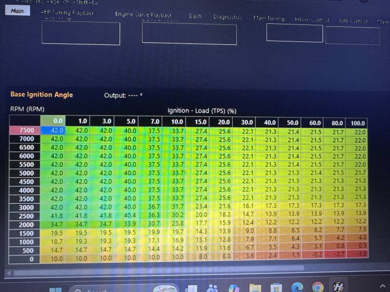

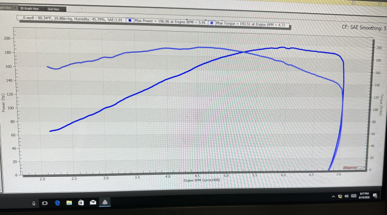

    Just dyno'd this 2.9L 10:1 with Schrick 284/272, ITBs and completely original AMC head with Supertech valves and OEM springs/rockers. This engine is knock limited for whatever reason on 93 octane (98 ron).
    Timing table is the max it wanted to handle without knock. I know AMC head isn't ideal. But my freshly rebuilt 885 had a crack and I just wanted to enjoy this car already hence was like F' IT and bolted AMC head to it. Have new 885 and maybe will drop it off to be machined and bolt it over the winter.
    What's your thoughts on this timing and dyno?

    I’d be looking at the cam timing with adjustable cam gear as a couple of members either here or old e30tech forum found a bunch retarding the cam . The cylinder head is definitely not ideal and likely restricting things somewhat.

        cam was set to Schrik Spec with adj. cam gear, 4deg. retarded.

          M52B28 is 193HP. This Dyno is more on par with N52B30, 231HP (196WHP with ~15% loss for the drivetrain). 60HP gain from stock M20B25( about 35% jump) is not exactly WAR chip kind of mod.

              Results are not bad. I wonder if there would be more area under the curve w/slightly less duration on the cam. With the amc head on it might be more optimized since max head flow would be less than an 885. 200 whp sounds fun though.
                  the power numbers are pretty good.
                  If you are confident the cam is dialed in to spec then it’s likely the head that’s holding you back a bit. The un modified amc is rough on the chamber and ports. I seem to recall it flows like 15cfm less than the 885 bmw casting and the shape is rubbish but I don’t know where I saw that. I haven’t cc the stock amc but as above the variation in cc seems plausible
                  What was piston to head clearance ?
