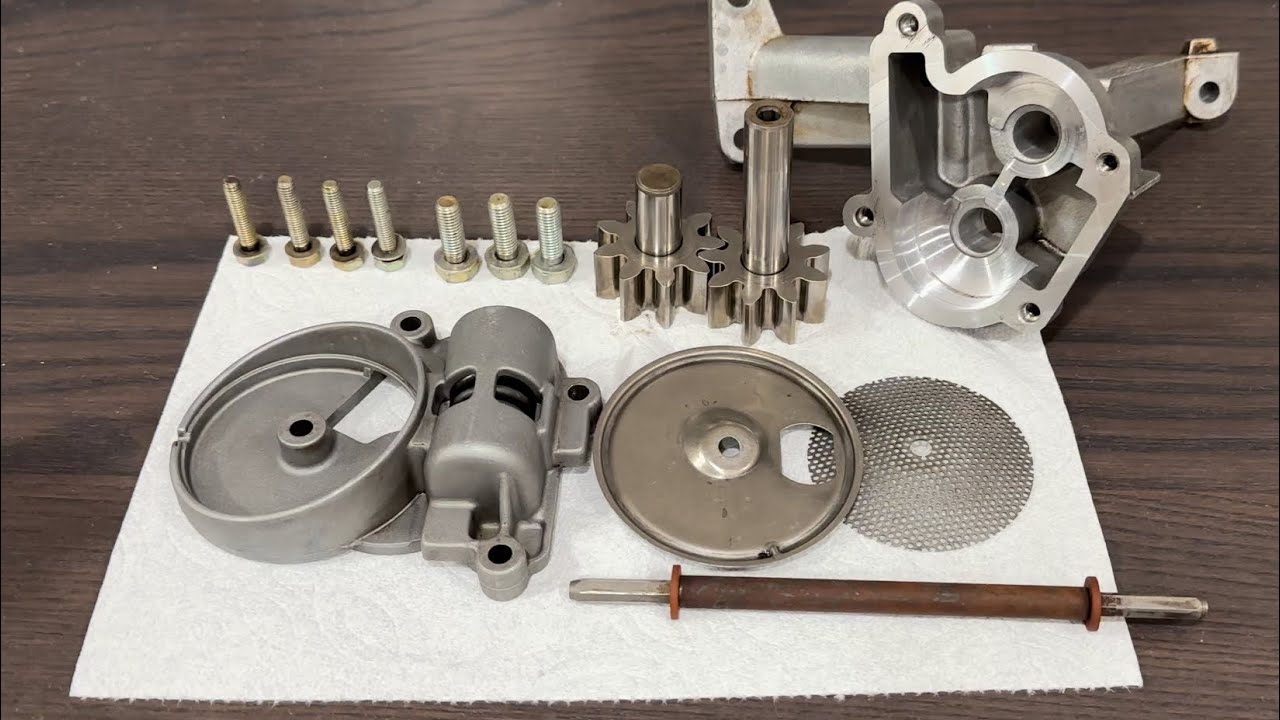

    I changed the oil pump with an old pump I had on another working engine and the same with the oil pressure relief valve just to be sure, but I still have the same exact symptoms. I have inspected both pumps internally and both seems in good condition.

          When I tore down both pumps they looked in good condition and everything looked very good actually but I changed it anyway just to rule it out.

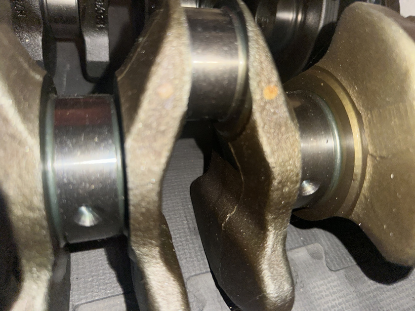

                    For starters, there are 3 standard size bearings for crank mains and one standard size for con. rods. Then there are 2 more oversized ones for both mains and con.rods if the crank was machined smaller (which can be from the factory as still within Specs) . It's impossible to say what was used at the factory unless measured. The biggest clue could be a color dot (yellow, white or green paint) on the crank next to each journal but I'd still confirm as there are 3 sizes for each color. But again, that color mark will only limits the selection to 3 part numbers. Otherwise you might have to try 9 different part numbers/bearing sizes.
                    Again maybe not your issue but wrong bearing selection will affect oil pressure. Also 10w40 is completely ok oil for m20. 10w50 will not make huge difference. I use 10w40 (Driven HR5 oil) and have 1.2-1.4 bar 93C hot idle and 3.7-4 bar at 3000rpm with 93C oil temp. My M52 crank was marked yellow but I confirmed every journal with plastigauge because as I mentioned, there are 3 different sizes of yellow or white or green.

                      Not the best picture but you get an idea. It's M52 crankshaft I have laying around. M20 marks can be more like brush strokes instead of dots.
