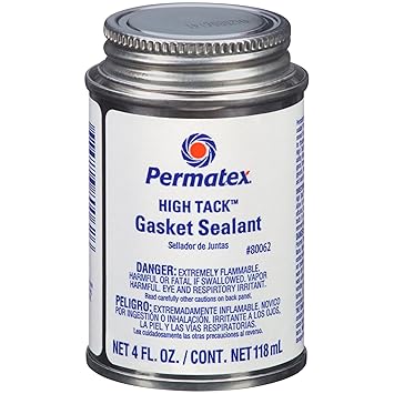

                most issues with cork gaskets is its failure due to the excessive torque, just don't tighten the crap out of it. Cork will naturally wick a little oil and there will be some minor oil film/dust spots. Many think it's leaking and tighten it more until the gasket just fails. Cork will dry out over time....long time.
                Not a big fan of rubber....:D rubber gasket have a tendency to displace rather than compressing. Supposedly, industry have shown this displacement can result in a 50 percent loss of flange pressure after 500 to 1,000 hours of engine operation.
                If your surfaces are clean and true, I'd do paper. MTC is still making their paper gaskets, about $6. You can use Gasgacinch as suggested or readily available Permatex High tack. It will keep the gasket in place during install and will take care of minor imperfections on those mating surfaces.

                  I use cork/rubber with some of this peanut butter

                      I would never use RVT on an oil pan that uses a gasket. The sealer I posted about is not silicone.
                      If you're not familiar with the feeling of how tight the M6 bolts need to be, I'd borrow a torque wrench.

                        Yer that stuff you posted is the good stuff. Theres another product called hyloma gasket something i use alot. I think it stays sticky like that stuff too.
