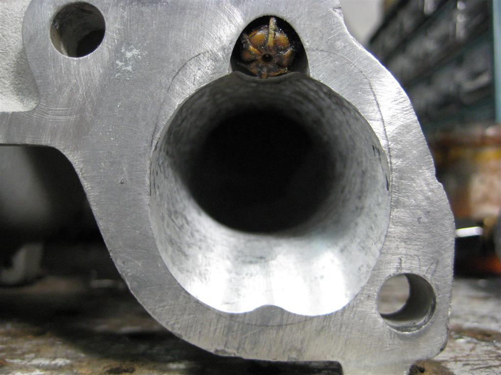

            Just an example of 1 test, which was the 2nd to last for the runner and 13 previous modifications lead to this design. It started as a small change to one corner of the port, make it symmetrical, another small change to 1 side, repeat. There was one test after this, with the bump completely removed.
            Did this help? Not really.

              Let's get the results more consistent when testing without a manifold.
              It follows the angle of the port entrance, then bell-mouths from there...

                  Any info on gasket matching the head and intake mani? any benefit to it? i already took the lower humps outta the intake mani, as in the pic above, maybe i shouldnt have done that.. But will the .2 liter increase in motor difference (2.5 vs 2.7) make up for the decrease in velocity, cuz i took some material off, due to the larger volume of air needed.
                  OR- probably not, but how bout using the SETA intake on w the i cam and TB? dumb idea? youd maintain the velocity and still have the volume needed. It may choke top end though?? How would this match the i cam profile. I think this is still on topic since its about benchflow and manifold/head combos..
