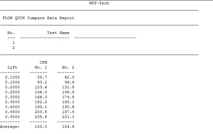

Let's see how much m20 heads suck.
  • ForcedFirebird
    • Feb 2007
    • 8300
    #196
    Can you guess which head has a cam lift rule? The median flow is really close, but these heads will perform very different pending cam/RPM.
