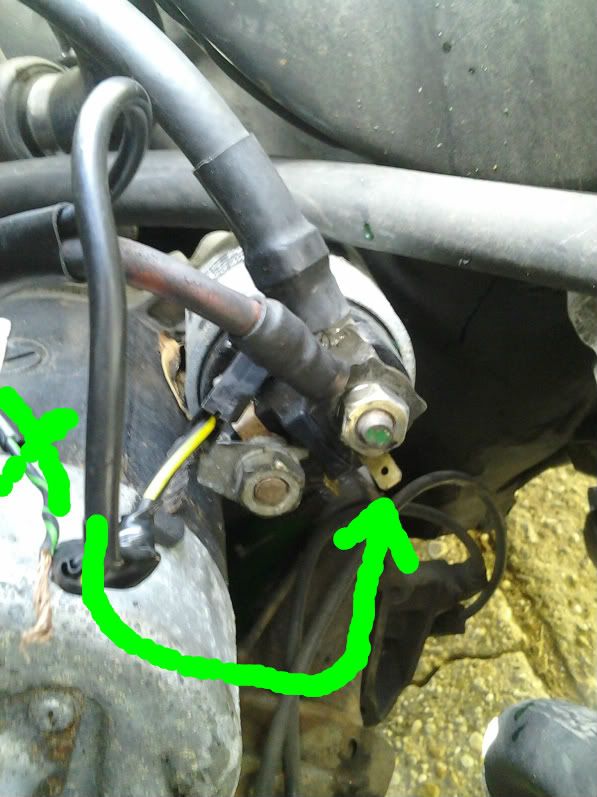

                  If you used an engine harness made after 9/87 it will have two small wires in the vicinity of the starter solenoid. One is for the unloader switch in late starters and the other controls the solenoid. If you used the ETA starter it will only have one small lug on the solenoid and if the wrong wire is connected the starter won't operate. And as MR 325 said, make sure the engine to chassis ground strap is connected.

                    make sure the 3 prong plug next to the DME is connected if its a early (87) I harness. Like posted above, if your running a late model harness with the eta started you will have a un used wire "unloader" Make sure your harness is connected correctly. Did you ground the harness to the battery tray?
                    I have a e to i set up and using a 90 harness. Started up just fine once i figured out the stater issue.
                    But like I said, If your using a 87 early I harness its all PNP and should start the 1st try. Did you plug the CPS into the other matching plug?

                      e30trooper-Those are the exact 3 wires i have for the starter. I see the red and back wire hook up to the same post. Now where does the black/yellow hook up to? On my starter i only have two posts

                        **UPDATE**
                        I found out where the starter wires go to but now when i turn the key to acc i dont hear the ecu come on nor the icv. Is it possible i could have fried something if i did not wire the starter correctly?
                        • jo3y
                          • Nov 2011
                          • 80
                          i was just about to tell you when i pulled my motor my starter wires were on the wrong post.
                          I doubt you fried anything, i just moved my hot wire to the correct post and it cranked
