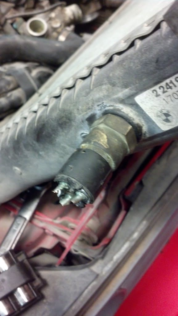

                  Thanks for all the suggestions, I ended up using the 1 1/4 and it worked. I ran into a snag, I decided to ignore it until I now (I am almost back together) when taking the radiator out the wires on the sensor (I'm guessing temp sensor for the fan?) were so brittle they broke from barley touching them.
                  What do I do now?

                    I guess i can strip the wires and grab some connectors or something, which wire goes where though?

                        I believe the middle wire is ground, one side is low speed one side is high speed. Should be able to match up the colors.
