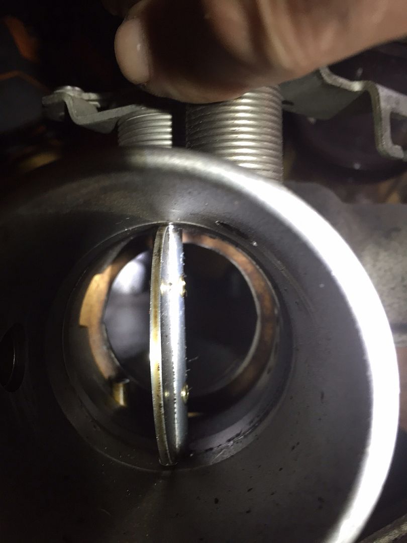

    The real problem with the 731 manifolds is the tiny throttle body they run. You can put a B25 throttle body on them but you can't bore the hole big enough to make a smooth transition.
    Í thought there would be too but I mocked it up on a bare head and it's pretty much spot on. I was surprised. I can try to take some pictures through the port.

                I was intending to use a b25 throttle body and afm but based on this comment the gain is limited without going to an 885 head or would you just bore the 323 intake as much as possible (leaving a step I assume) and call it a day ?
                You throw the 731 manifold in the aluminium scrap bin and pick up an 885 manifold.
                I have a 2.7i with 731. At first I installed it with 731 manifold ground out as much as possible for an 885 throttle body but it always felt like it was strangled the higher the revs climbed. Swapped to 885 manifold and it pulls clean through the rev range. Still feels a little choked above 5,500RPM but I guess that's normal for a stock M20 head especially with the smaller 731 valves and stock cam.

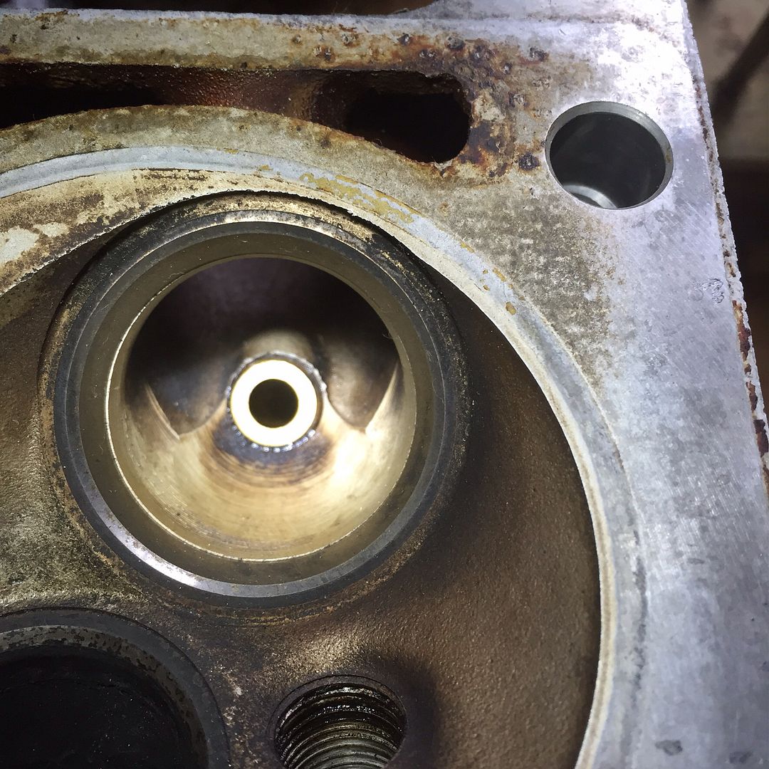

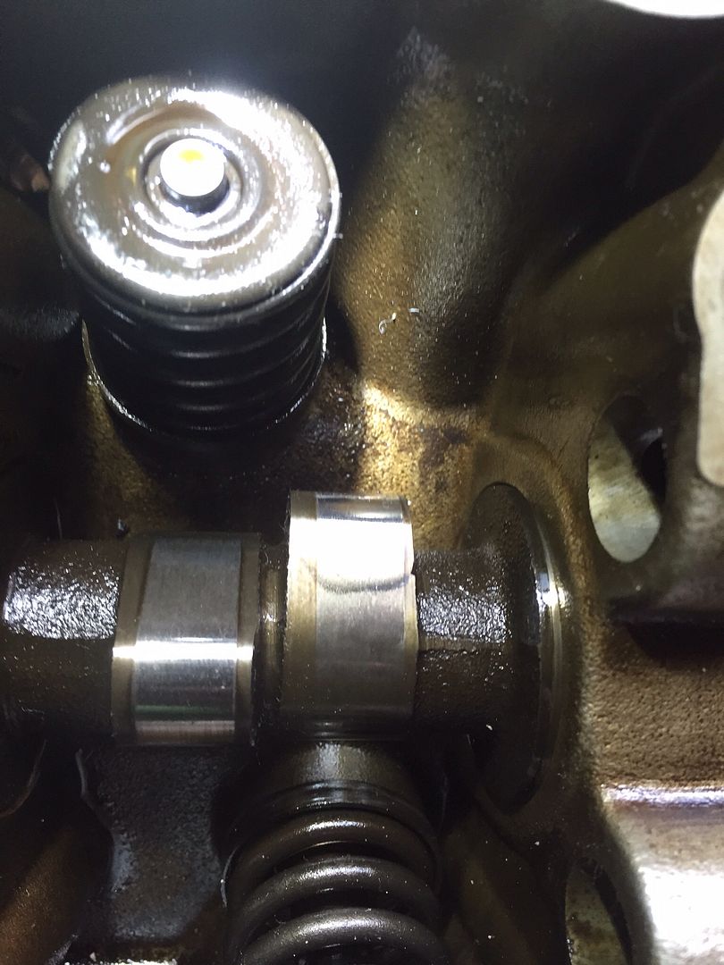

                        I've been quiet here after the seller of the 731 went dark as soon as unpaid him (funny how that works). The good news is that the head did arrive and aside from a couple of bent studs it looks to be in fine shape
                        The rockers slid out nicely and there's enough meat on the valves that I'd say the head has never been worked on. In light of mad hatters comment about the 885 TB on the 731 intake here's a pic of t
                        The difference. It's 8mm total and the only place there isn't 4 to remove is at the very bottom. I'm guessing that's a 95%+ match which, given what a hybrid this thing will be, would seem to be close enough. This is especially true given that I may keep the rest of the stock ETA externals til I can acquire all the b25 parts.

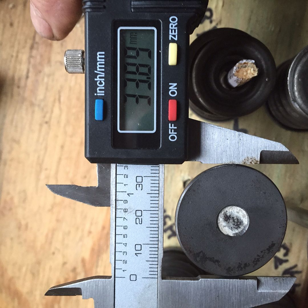

                          I broke down my 731 today and was surprised to find the exhaust valves were only 34mm. It's listed at 36 in some of the material I've read. Clearly not the case
                          it looks to even my untrained eye that there is room for a quite a bit of cleanup in the ports. Sure doesn't look like the one Rama did.

                            #58
                            Id appreciate some input as to whether I can put in larger valves without changing the seats.

                              #59
                              The exhaust ports are much worse than the inlets for requiring clean up but yeah, that rough area behind the valve guide is what I was referring to when I said there's some clean up you can do yourself.
                              I think you can do the 42mm valves but you also need to unshroud them to make it worthwhile and blend the seats in.
