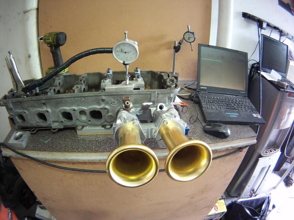

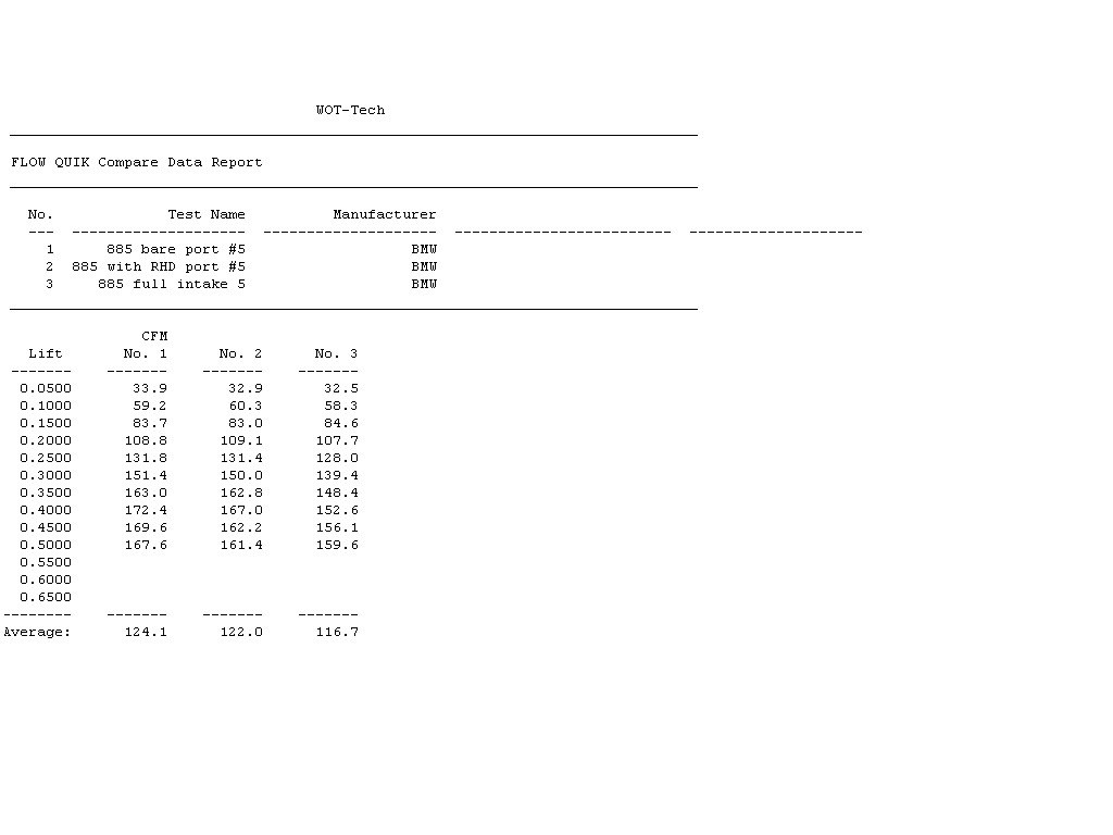

                        #86
                        Flowing the throttles today. Interesting enough, the m20 head is efficient enough to max the 40mm TB's in terms of flow, which is probably a good thing when taking velocity into consideration (a 40mm throttle with butterfly should flow 167-ish CFM). Here's some data. Bare head with a port entrance fixture attached, ITB's attached, then stock mani attached.
                        Here's a graph showing the flow difference. Kind looks like RHD's test mule dyno plot.

                            #88
                            With stock mani attached, was the throttle butterfly also attached?

                              #89
                              And pinned open.
                              You can see more about our flow testing methods here...
                              john@m20guru.com

                                #90
                                And because pics are fun.
