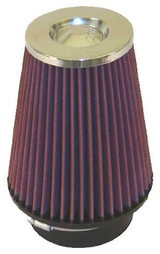

                            Replaced the high beam headlights with these 5-3/4" velocity stacks. They fit nicely on top of the headlight cans. Outlet is 3-1/2" OD. Passenger inlet is for turbo intake air box. Driver inlet is for engine bay cooling.
                            Using a K&N RC-4680 filter. 4" ID flange, 6" base, 4" top, 7" long.
                            Filter is not here yet, so I made a cardboard prototype to size up the space.
                            Prototype air box for the filter. Will be covered in the same fiberglass / aluminum heat shield I used for the firewall. Any way to keep engine bay heat out of the intake is good. PV = nRT is a law, not a suggestion. This post has some good real world data. Lowering turbo intake temperature by 20 F resulted in 30 HP gain.
