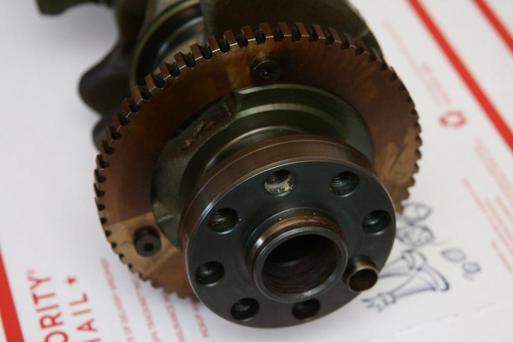

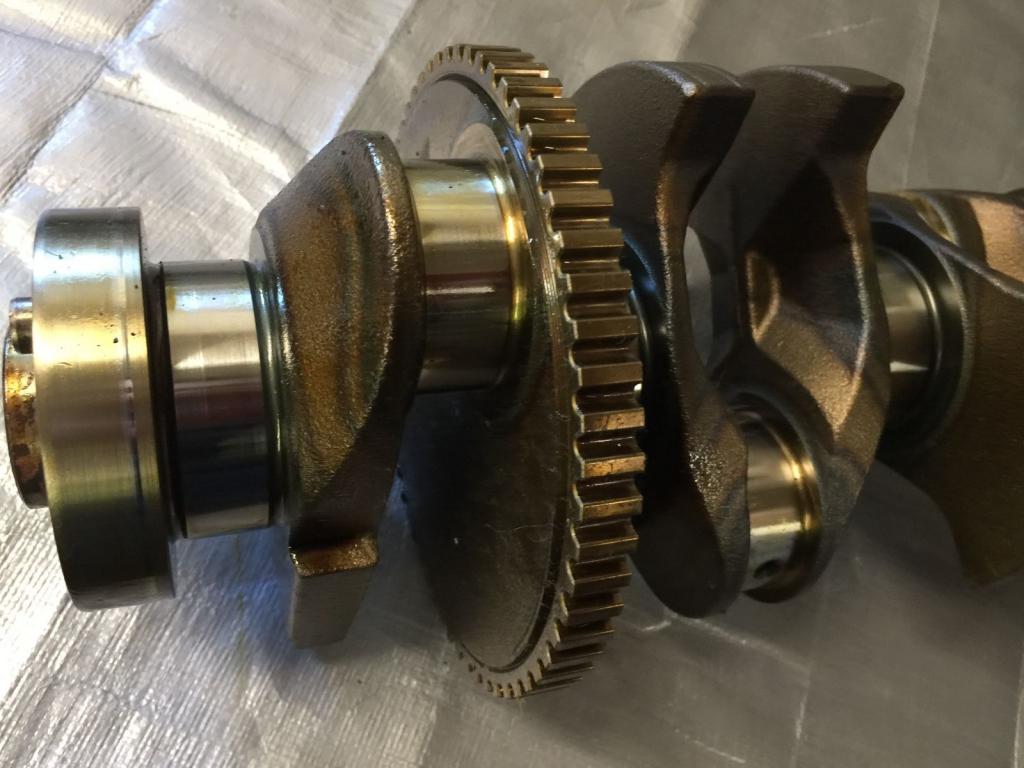

                I have small grove in my crank seal, nothing crazy but it's there.
                Looks like this crank had regular elastomeric(spring) seal on it, based on the wear pattern.
                New BMW seal, PTFE seal (no spring) has totally different profile and wear pattern. Obviously PTFE is much better technology but I'm not sure if it will work with current wear grove. Looks like PTFE has wider wear pattern and slightly tapered due to the seal profile.
                What do you guys think? Would you still use PTFE?
