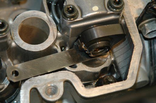

    So after finally getting my 2.8 together and in the car, I was rewarded with a very disappointing and resolute no start condition. A month of trouble shooting later, I finally took the valve cover off to make sure that at TDC, with the cam sprocket mark aligned with the head, and the rotor pointing in the correct direction (I had already checked that), that the cam lobes were also pointing the correct way. I mean, the cam sprocket only goes on the cam one way, and the rotor mount and rotor only go on one way, so it can't be 180 degrees off, right?
    Well, I was somewhat relieved to see that the #1 cam lobes in this all-lined-up situation were in fact holding both valves slightly open; not the recipe for productive combustion. Just to make sure I wasn't having some kind engine theory comprehension failure, I went in the shed and verified that a stock cam, sprocket, and rotor indeed left the cam lobes in the opposite orientation.
    At this point, even though I was alone, I expressed my disappointment with Dr. Schrick out loud. Mostly though, I was just glad to have found an obvious explanation for the no start. Eager to validate this obvious solution, I modified an old rotor and installed it the opposite direction with 2 of the 3 screws. Sure enough, it started like I had just turned it off yesterday (not 20 months ago, as was the actual case).
    Has anyone else ever seen this?

    so the cam dowel pin was drilled 180* out? i know one guy who had the engine lunched because the dowel was off

      The pin bore is more like 184 degrees off. I had set the cam angle based on the valve lift specs at TDC from Schrick, but didn't notice or realize that it was the wrong TDC for the ignition rotor angle. So everything was OK for compression, but the spark timing was completely off. I'm assuming that's the only problem with the cam, but I guess I should check the valve lifts etc. The valve to piston clearances seemed reasonable. It's a 284/272.
