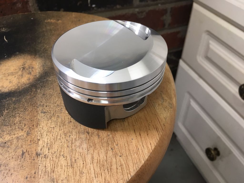

                        • cdeason7
                          • May 2016
                          • 38
                          This is a piston that TopEnd designed for my engine build (E36 2.8L crankshaft and rods, 885 head,CR 10.7:1, Schrick 280/272 camshaft) using the 4032 forging
                          • digger
                            • Nov 2005
                            • 6198
                            How recent ? je or cp ?
                            • cdeason7
                              • May 2016
                              • 38
                              A few months, JE, my engine builder prefers working with JE,
                              Design look ok ?
