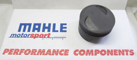

                When working with the engineer at Mahle, I sent in a sectioned 885 cylinder head to be scanned, along with the piston. Since he's with Mahle, he was actually able to pull up the original OEM drawings and use them as the base when drawing these.
                Also specced for this specific piston was the 284/280 cam. And yes, the system was setup for 91 octane.
                Here's a couple old comparison pictures. You can see how the cnc milling on the MahleMS results in the mirroring of the stock dish angles, while using the blank forging you can get close, but not quite the same.
