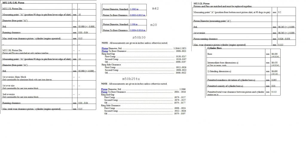

        isn't nominal clearance 0.02mm ? Most Pistons say 83.98mm so with 84.00 nominal bore that is 0.02mm?

          Originally posted by ForcedFirebird
          Reread my post. Where did I say piston wear? Total piston to bore clearance is .0012" on this high mileage engine I broke down for rebuilding. I build these engines often, not just pulling numbers from thin air.
          I think he means that whatever wear is there is included in the measurements. This reinforces that it came tighter from the factory though.
            Correct, =/-.009mm allowed piston variance which almost half that but I have found the Mahle to be very stable. I used screen shots of software to make a listing of typical BMW engines and their respective piston clearances. Not only the m20 has tight jugs.

                Originally posted by zaq123
                you guys are jumping from metric to english..... adds some more confusion to this discussion. :)
                As you can see from the pic I posted, one has to be on their toes ("in inches unless otherwise noted"). Even the manuals jump back and forth unfortunately.
