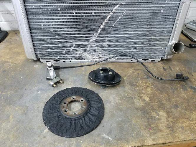

    Apparently the stock crank damper does not like 8000 RPM.
Name:	blown up m20 crank damper.jpg
    any chance you could cut it up and measure the rubber bits and steel so i can model in CAD and do some calculations? you could always send it to me
    Leave a comment:
