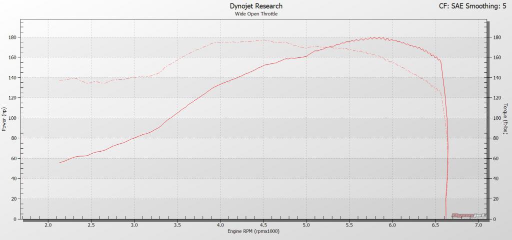

  • ForcedFirebird
    replied
    Originally posted by jeffnhiscars
    Could the extruded intake have made that much difference and if I may ask what that costs ?
    I have a feeling the diff is causing parasitic loss. Going to pull it out tomorrow anc check it out.
    Originally posted by digger
    It's amazing that both graphs are basically identical upto 5000rpm.
    So the first has
    - standalone ecu
    - header
    - exrtrude hone
    - bbtb and fine style inlet
    - tighter squish clearance
    But the second has a IE 272, is it regrind or Schrick knock off ?
    New cam.
    Two other differences are the first one has 3.73 final drive, second has 4.10 with oil pressure relief blocked (~80ish psi oil pressure max), and first had 10w40 conventional, second had 10w60 (~65 max oil pressure) - but don't believe the oil made the difference as they both were hot enough.
    Leave a comment:
  • digger
    replied
    So the first has
    - standalone ecu
    - header
    - exrtrude hone

  • ForcedFirebird
    replied
    Originally posted by redlightpete
    Did these both have stock cams and non-adjustable cam gears?
    Originally posted by LowR3V'in
    have you seen any power from retarding the cam seeing as allot of people resurfaced/shaved heads but with no adjustable gear.
    Honestly I have not done much with the adjustable gears on the dyno.
    Here's the graphs from Sat.
    81mm crank, 130mm rods, b25 pistons, .080" (2.03mm) off the deck, stock cam (and cam gear), in house rebuilt head, .035 quench, bored throttle body, extrude manifold, eBay headers, single 2.5" exhaust through 2 mufflers. MS1 with a smooth elbow pipe, cone filter.
    81mm crank, 130mm rods, b25 pistons, .080" (2.03mm) off the deck, IE 272 cam (stock cam gear), in house rebuilt head, .050" quench, stock intake/TB, stock exhaust manifolds, single 2.5" exhaust with a single resonator. Stock ECU re-mapped at the dyno.
    I believe this car "should" have made more power, was actually a little disappointed. Later after watching a video sent by a friend, I can hear a lot of diff noise that was impossible for me to hear in the car while tuning (one car bay with a dyno in it). Doubt we will bring it back to the dyno, just rebuild the diff and send it racing.
Name:	22 endurance car.jpg
    Leave a comment:
