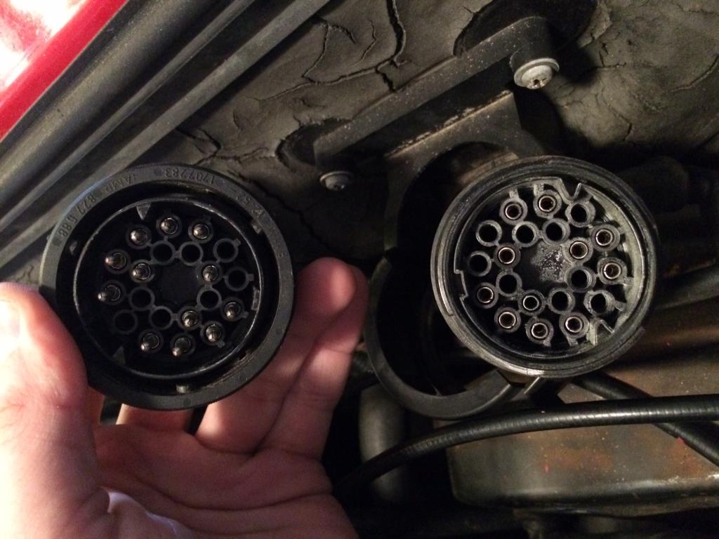

          #454
          Originally posted by lateracer
          I've got a 06/86 e (Motronic 1.0 system) that I'm doing a 1.3 upgrade on. I'm ready to swap out the harness and the 1.3 harness fits right on to my stock c101 connector. I know when people had the older square connector some wire splicing needed to be done, but I'm not sure about this.
          Do I need to move some wires around or can I just plug the 1.3 harness into the 1.0 connector and go?
          I took a photo and there are clearly some pins on the 1.3 side that won't be connected to anything on the 1.0 side.
          I think the answer to my question is "Yes" but I'm not sure if I've read about systems getting fried from just plugging and playing. Wanted to be sure before I reconnect the battery.
          Been doing some digging, and now after reading this post and its entire 30+ pages twice now, I still haven't found the definite answer. I'm concerned with the same issue that lateracer posted above back in 2010. I've got a near identical setup to his, '86 eta, swapped i head and all necessary parts, using an '89 i harness and 380 ECU, the harness c101 connector fits the body, but the pins don't match exactly. Many have mentioned it's "plug and play" but unlike a few success stories on here, I'm not "firing right up". Here is the engine harness with 12 pins, and the body side with 11 spots.
          Does something need to be spliced in here to get it to run? I feel fairly confident everything is connected correctly, but don't know what I am missing. When I turn the key I don't hear the fuel transfer pump, when I jump the fuel relay it fires right up, so pump is good, checked the relays - good, starter engages and engine turns over but it doesn't fire up. I've tried swapping the crank ps and halifax ignition sensor connectors, same results. There are a few wires near the ECU connector that I have no idea what they go to. One brown (should be a ground?) and the other blue/red. Anyone have an idea what these are for?
          If anyone who has done the e to i swap and encountered similar issues I'd really appreciate a point in the right direction. I'm so close!

                    Also to anyone following on my previous post regarding the C101 connector - the issue with the mismatched number of pins was not an issue for me. I got my car running with no alterations or hacking of the wiring harness. An 86 eta and a 89 i harness WILL work!

                            And ForceFirebird, do you have a picture depicting which pin on the C101 is the #20? I guess I got plain lucky I didn't fry mine when plugging it up. I do have an issue overall with my setup, the engine revs will fluctuate when warmed up and the gas pedal is down, suddenly cutting out and recovering. Haven't identified the problem yet, wondering if it doesn't have something to do with my wiring. If I can't figure it out soon I'll have to take it to the local indy.

                              I don't have a pic handy, but if you peel back the rubber boot the numbers are next to the pins (also on the face side when unplugged).
