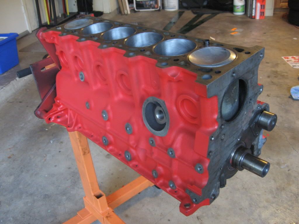

        #33
        Finished painting:
        '88 325is
        VP UT of Austin Autoholics
        BMWCCA 380364
        • E30Idea
          • Mar 2007
          • 2196
          #34
          Originally posted by Jordan325iC
          Finished painting:
          Awesome build and great work. But dude, That block (with all due respect) Please repaint it....... any other color..... Black maybe?
          Just razing you though. StereoInstaller and I are doing the basic same build for my car right now. I should be done in a month or so. Keep up the great work!

              #36
              I am painting it red as an homage to the volvo redblock engine, which has been powering the car that has been hauling my ass around while I blow money on the e30.
              Trust me, I don't like "bling" in the engine bay at all. There is no chrome piping or blue couplers in my engine bay, everything that can be made black or OEM looking has been. However, a bright engine block serves the purpose of making it easier to track down any leaks, should they arise. Tracking down a leak on a black block is nearly impossible.
