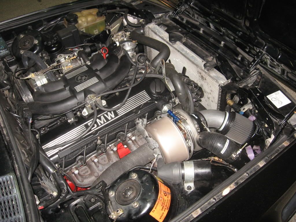

                      Engine bay (needs a bit of cleaning up):

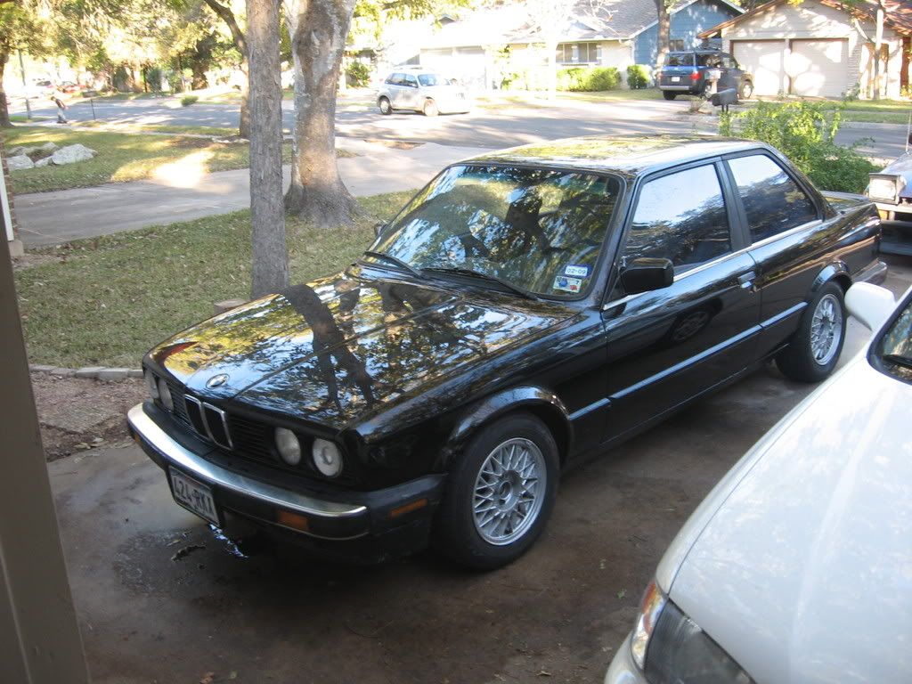

                      The car:

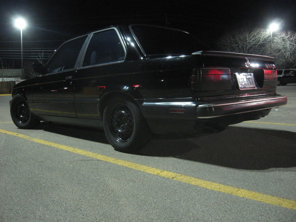

                          holy rack 'o' vaccuum lines batman. Be careful with those smoked tails, I am running a set like those, and less than 5 days on the road, someone ran in the back of me. No damages, but still....

                            OP, very nice, hows it feel with the turbo? thats a tiny air filter lol

                                Yea, there are a lot of vacuum lines. All necessary however, and only 1 "tee" in the whole setup (FPR and RRFPR share). I will clean it up in the future by changing those two straight vacuum barb fittings to 90 degree fittings.
                                Made a $150 order to Summit today, should address a lot of the issues. Nice big air filter too.

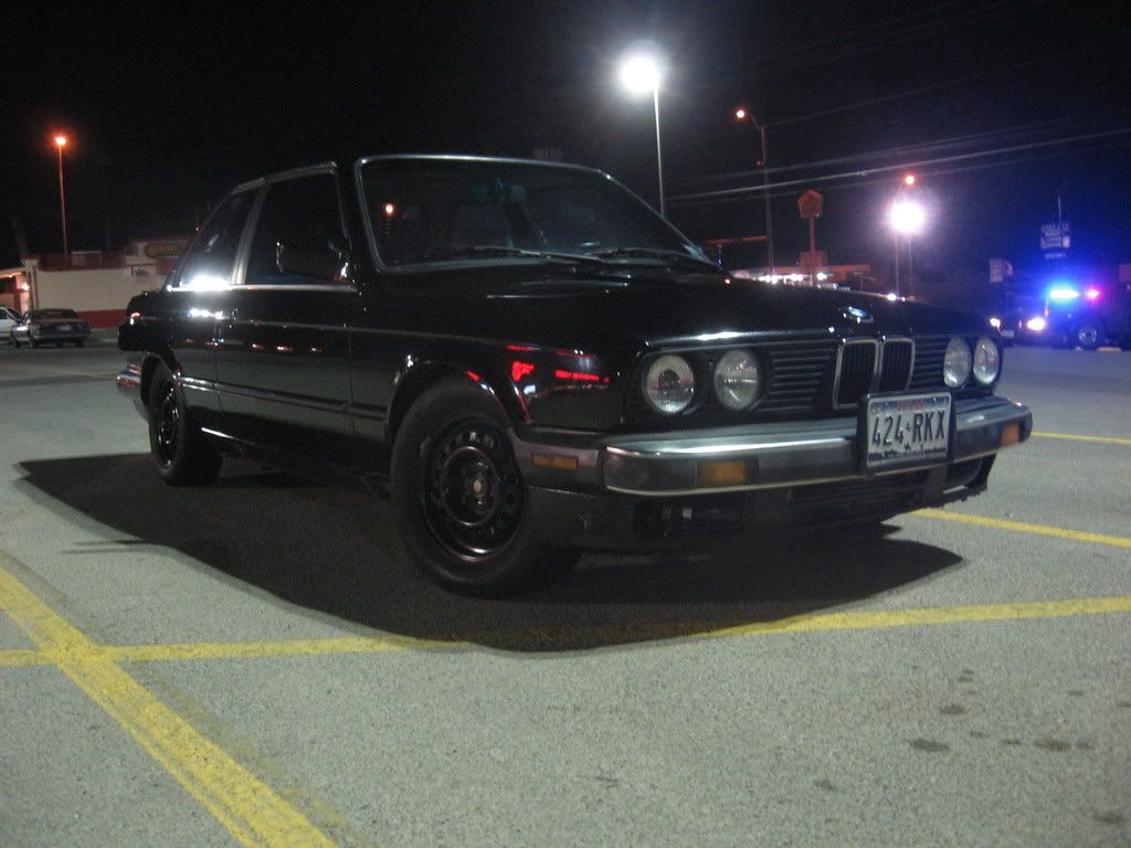

                                As for the tail-lights, I got them in a junkyard while traveling for really cheap. I primarily drive the car at night (camouflage, you know) so it they're fine. They aren't as dark as the picture makes them out to be.
