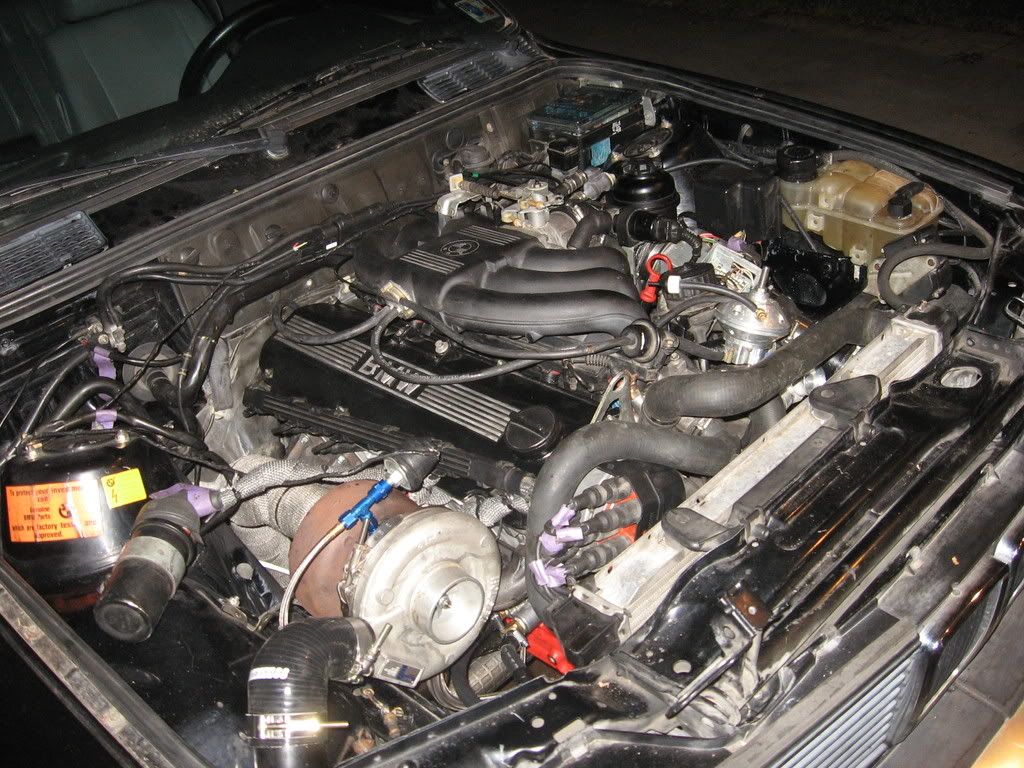

                        The car still doesn't run. It will crank and crank, sputtering occasionally if I give it gas, but it won't catch and idle.
                        Spark plugs are sparking
                        Fuel pressure is good (47psi).
                        Fuel is getting into the cylinders (all plugs smell like fuel).
                        Both head and bottom end were at TDC when new belt was installed correctly, spun a few times.
                        I assume compression is good, since the bottom end is freshly rebuilt.
                        It ran fine before I pulled the engine out. I've double checked all the connections and grounds and everything seems great. I swapped out the chips just to see if maybe it would help (and it didn't).
                        I have a few more possible ideas, but at this point I'm open to suggestions.

                          well you're getting fuel, so how about spark? is the coil getting power? are the plug wires on in the right order?
                            I labeled all the spark plug wires before I uninstalled them, and reinstalled them in the same position. The coil is also plugged in so I assume it's getting power. As I said, the plugs are definitely firing. It's weird because I have all the ingredients for a running engine, they're just not coming together right for some reason. I'm going to buy a timing light on Wed. and double check my timing, but I doubt that's it because everything was double checked when I put the motor back together.

                              double check the plug wires anyway. it sounds dumb, but it's pretty easy to mix them up. I've done it before.
                              also, just because the coil is plugged in doesn't mean it has power. check it with a voltmeter.

                                OH SHIT. It just occurred to me. The coil is supposed to be grounded, right!?
                                I can't really see any grounding going on there. I don't remember grounding it.... I think the mystery is solved.
                                Edit: Fuck yes.
