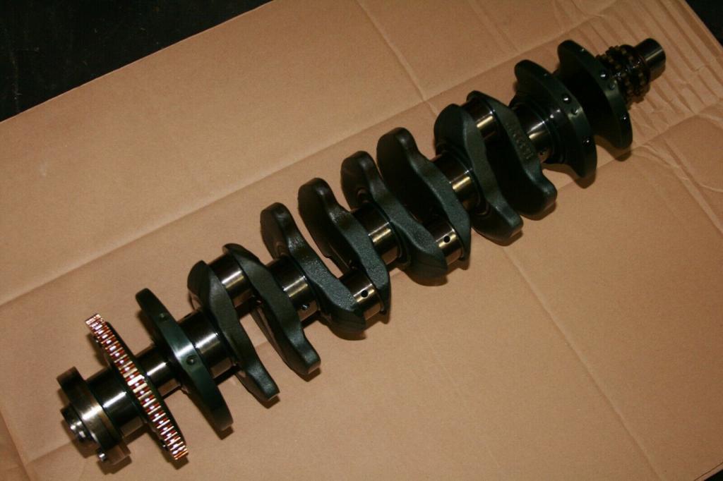

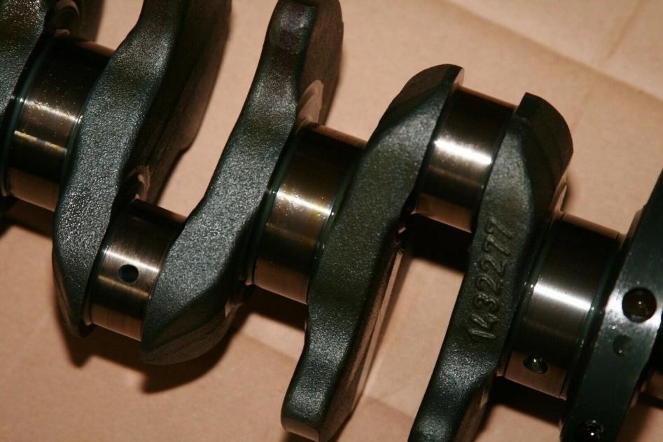

                    here is1432277 crank, 84mm stroke

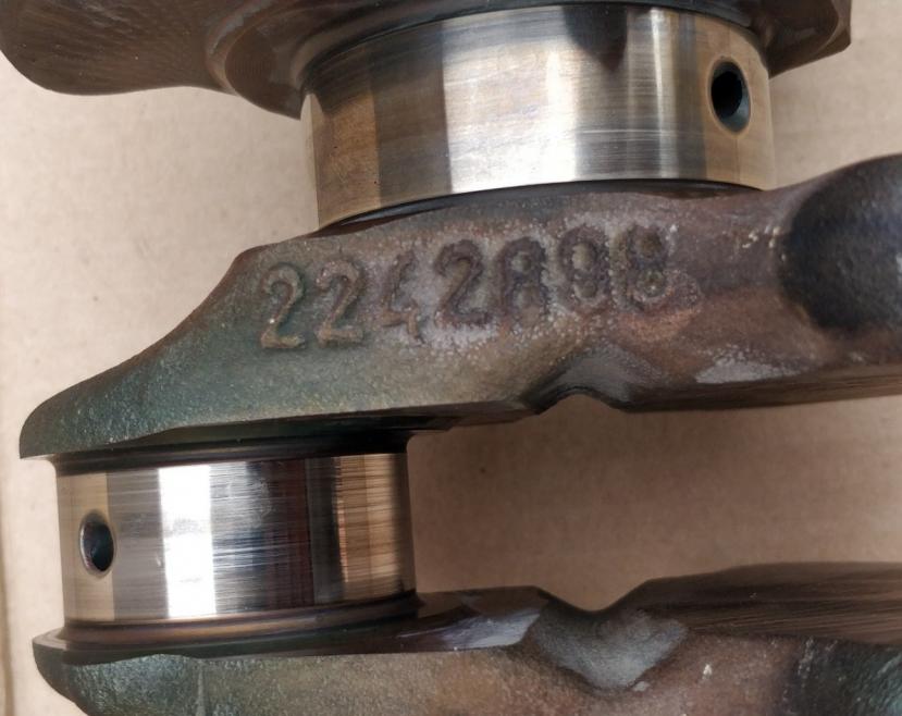

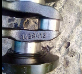

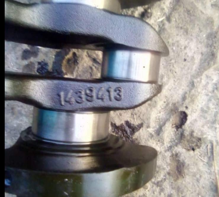

                            Looks like the most popular M52 2.8L crankshaft casting numbers are:
                            1) 1432277
                            2) 2242898
                            Although there is a diesel M51D25 and S50 2.5L engine crankshaft with this same 2242898 casting number so you probably need to ask what engine the crank came from if you find one with this number.

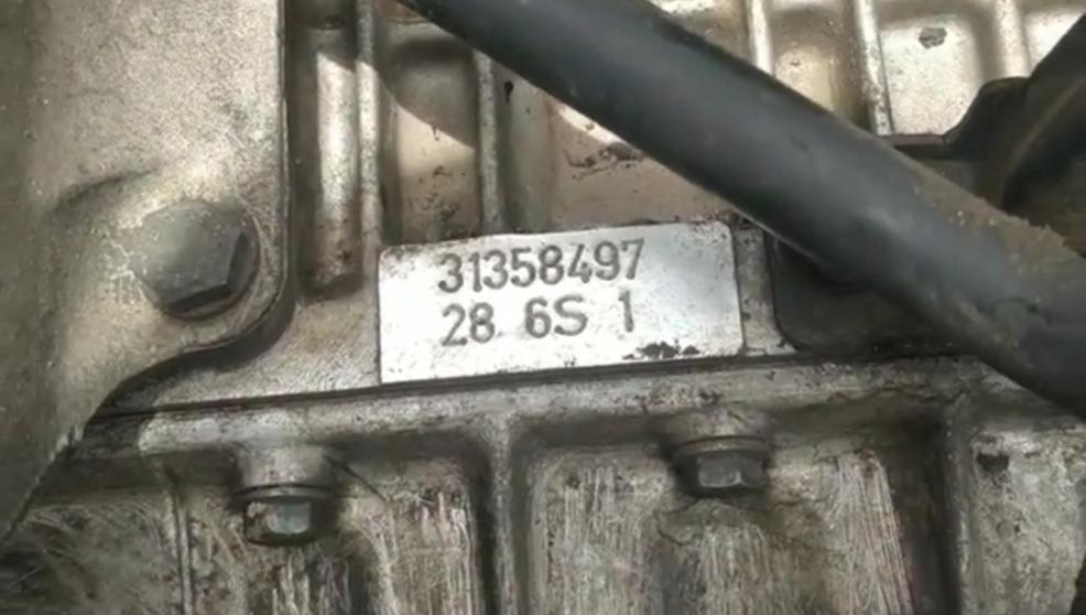

                            Now to my question. I got two M52B28 single VANOS engines with the following block ID stamps and crankshaft numbers:
                            Engine A:
                            31358497
                            28 6S 1
                            2242898, C38 (crankshaft cast numbers)

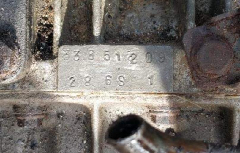

                            Engine B:
                            33851209
                            28 6S 1
                            1439413, NC38 (crankshaft cast numbers)

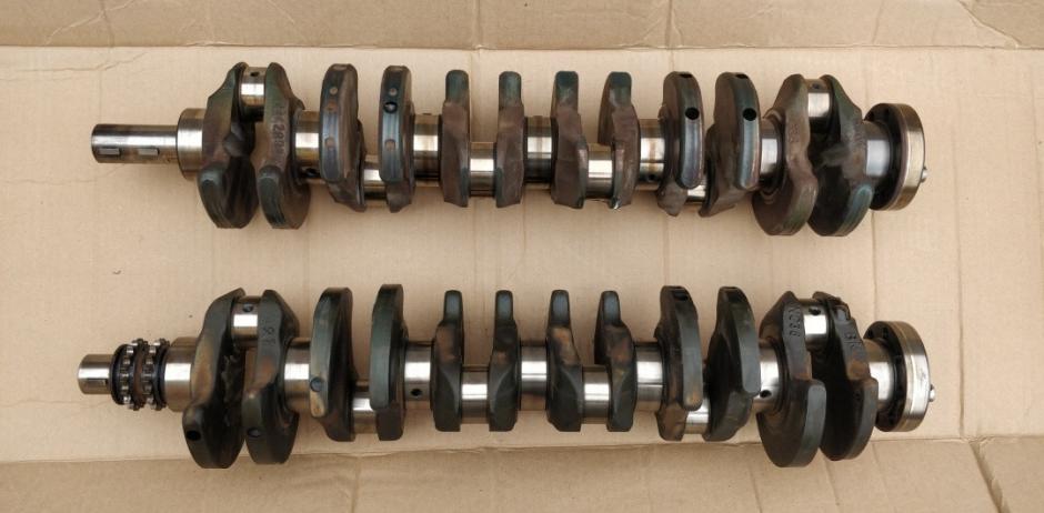

                            I have not come across this second 1439413 casting number anywhere on the internet and it does have some physical differences with the popular 2242898 one pictured side by side here. I am 100% sure this is from a 2.8L M52 single VANOS because I removed them myself on the same day.
                            Question 1: Is it possible for the counterweights to be different in shape/placement but have the same 84mm stroke?
                            Question 2: Is the condition of the first crankshaft good enough to reuse?
                            Click image for larger version  Name:	engine A block number.jpg Views:	98 Size:	62.8 KB ID:	10054380
                            Engine A block
                            Click image for larger version  Name:	engine B block number.jpg Views:	97 Size:	67.2 KB ID:	10054381
                            Engine B block
                            Click image for larger version  Name:	engine A crankshaft.jpg Views:	96 Size:	58.0 KB ID:	10054384
                            Engine A crankshaft
                            Click image for larger version  Name:	engine B crankshaft.jpg Views:	98 Size:	56.6 KB ID:	10054382
                            Engine B crankshaft
                            Click image for larger version  Name:	both crankshafts.jpg Views:	95 Size:	51.3 KB ID:	10054383 Both crankshafts side by side. 2242898 on top.
                            1990 325iS
                            1990 318iS (sold)
                            • digger
                              • Nov 2005
                              • 6196
                              there are different versions it looks like your Crank A does not have the moninting for trigger wheel so this might be the smaller counterweight version which is the one to use
