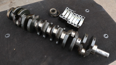

Help! Is this a M52 Crank?

    Both cranks look ok for re-using. Both seem to be the C38 crank family that fits into M20 without problems.
    84mm crank with integrated triggerwheel does not turn freely in M20B25 block (without modifications).
      Depends on what they cam out of. Outside the US, you guys have more options than we do. The early Euro m52 had the crank reluctor in the front (OBDII was only mandated in the US in 1996) - the Euro crank has shorter throws. In fact, Euro cranks clear late model short skirt pistons. The m54 (and m52tu) cranks have narrower throws that are larger in diameter, resulting in a lighter crank with more interference in an m20...

        Resurrecting this thread. So the 84mm Euro smaller counterweight crank eliminates the need for clearance machining on the block?
          Should do, but clearancing the block is easy as. The bigger issue is clearing the piston skirts but normally only if using OE pistons

            Thanks Digger,
            I sourced one of these Euro 2242898 M52 cranks out of Scotland but I think the freight forwarding shipping cost I paid is equal to any additional block machining cost. I will photograph mine and share on the board when I get a chance. It is from a 1997 BMW E36 2.8 Manual
