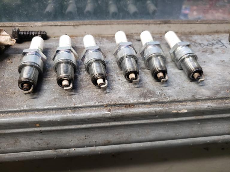

  • JehTehsus
    replied
    Originally posted by Northern
    have you used LM programmer to verify the LC-2's analog 1/2 output to make sure it's actually outputting what's expected?
    I set up an LC-2 a year back and it was fine, but my LC-1 came preset to the wrong multiplier for gasoline.
    I have not - but I also don't think that is the issue, because sometimes I can get it to hold stableish AFRs for a a bit.
    So screwing around last night at (high) idle of 1300RPMish, I shut off auto tune because according to the AFR gauge it was massively leaning things out (and the VE table looked really low). Took about 2 minutes to get the VE table to reasonable numbers and the idle much more stable just by manually tweaking.
    I am starting to suspect a vacuum leak and/or an intermittent injector, and plan on doing some tests there this afternoon. My reasoning here is as follows;
    • The fuel pressure regulator often doesn't seem to 'respond' to changes in MAP below ~80 kPa. This results in inconsistent fueling, at least when driving. I have seen pressures (absolute) from ~270-330kPa, they should be bang on at 300 and steady. This is being logged by the bosch sensor on the fuel filter, which is not super close to the rail, but even so it seems odd to often not see the FPR do anything at all (when MAP is 80-100kPa it definitely does - you can see the FP change basically immediately to follow change in MAP). The regulator also seems to be leaving me a bit high on the FP side, in the below log snapshot it is holding about 312kPa, should be 300.
    • My plugs seem to be all over the place. I have attached a couple pictures of them - cylinder six is on the left, one on the right, six seems a bit fouled.
    • I may be reading too much into this... but the AFR gauge, under my relatively steady idle conditions (@1300rpm) seems to be spiking every 1.8s, which to me indicates a single cylinder is under fueling (based on plugs, probably *not* six... which looks to be overfueling :/). I don't know if this is an issue with the IDs or not - my understanding is they are relatively good at low pulse widths, and I believe I have the low pulse width control setup properly in the MS, based on the data they have online.
    If anyone has any other ideas, I am all ears. Hopefully a vacuum leak check doesn't take too long...
    I may also route my FPR pressure reference to the manifold directly instead of the vacuum station. Right now the vac station + FPR reference line totals maybe 2.5-3ft of (4-6AN) hose. I could probably route it right into manifold and shorten hose to a foot or less. I would expect this to show up as a delayed response though - not just plain 'ignoring' low MAP levels.
    These are the plugs (6 - 5 - 4 - 3 - 2 - 1 left to right)
    Click image for larger version  Name:	20201028_162500.jpg Views:	0 Size:	71.0 KB ID:	9958124
    Click image for larger version  Name:	20201028_162543.jpg Views:	0 Size:	69.3 KB ID:	9958126
    Here is a log snapshot. This is after quickly dialing in VE around where she was idling to keep things in the AFR gauge range. I think the gauge is working fine and telling me something else is wrong lol. Note that the pulses are almost always ~1.8s apart, with some occasional other odd behavior.
    Click image for larger version  Name:	more_idle.png Views:	0 Size:	264.0 KB ID:	9958127

  • Northern
    replied
    Leave a comment:

    Didn't get to my second drive test... had a bit of a scare with total coolant loss on the driveway. My Bosch temp sensor indicated 114c for a minute and a half or so (I was messing with headlights in the dark with it idling... didn't notice lower Rad hose barfing everywhere).
    Anyway moved it back into shop after refilling coolant and letting it cool down. Pulled plugs, did a quick comp test, checked under valve cover very carefully for cracks. Cylinders all ready ~150psi. No visible cracks. Started it back up and idled till up to temperature and everything *seemed* ok, no disappearing coolant.
    I do think something is up with injectors though - I cannot seem to maintain a stable AFR. I don't think this has to do with my fuel pressure - I may have an issue there (I suspect a vacuum leak) but I get rapidly fluctuating AFRs even when it is stable.
    My number six plug also seems a bit fouled, number one looks good, and the others maybe a bit lean.
