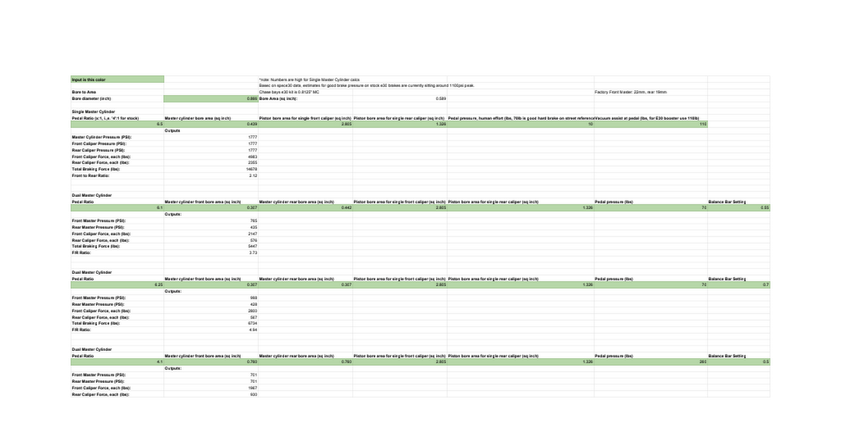

              Ok, I have tried actually putting together a calculator for comparison purposes.
              Running the numbers like this it does seem obvious there is an issue... in fact, I am kinda hoping I am buggering up my math. But I think originally I was assuming that at 70lbs pedal force, both MCs would be seeing 70lbs, whereas in reality they only see 35 (with 50/50 balance).
              Essentially, stock brakes with vacuum assist (and ignoring proportioning valve), I am getting roughly 4500lbs at each front caliper pad and 2000 at each rear caliper pad, for a total of 13000lbs. Realistically it will probably a little higher because the proportioning valve will introduce a pressure imbalance, and high front caliper pressure but lower rear caliper pressure will equal more overall caliper grip force in lbs due to larger area of front pistons. That being said, rotor diameter, weight transfer, grip etc. all come into play so these numbers are for reference comparison only.
              Now, if I run the exact same calculations with dual masters @50/50 balance, 0.75" bore, 70lbs of human effort and a 6.9 pedal ratio... I get 1515lbs for each front caliper and 675 for each rear, i.e. ~4400lbs total, or basically 30% braking force at the rotors for equivalent human effort. Sweeeeeet.
              What really sucks, is if I run the same numbers but with 0.625" MCs front and rear, and a 50% front bias, I am getting still only around half the equivalent force of the stock setup. Bringing pedal force up to 140lbs brings me into the right neighborhood, but I am not sure I am comfortable with that kind of effort repeatedly. Certainly with 0.75's front and rear I would need to be putting 200lb on the pedal. Yes, I can do a one legged squat of my 200lb fat ass, but I am sure as hell not doing that all day.
              Now, all this goes out the window once you start moving to larger calipers. With something closer to 3.5sq inch front caliper area (say, 1.5" bore dual piston wilwoods), at 70lbs pedal force and 50% bias you see 2780lbs at the calipers. If you are also running larger diameter rotors I would not be at all surprised if this translates into a really good brake feel.
              Anyway if someone wants to check my math so I can throw all those numbers out, that would be wonderful:
                https://docs.google.com/spreadsheets...it?usp=sharing
                one thing im not sure of is if you put 1000lb into the stock 22.20/17.46 MC what is the pressure you in the FR and RR lines. is it apportioned inversely proportional to area? are the two pistons in linked on common shaft of is there just a spring coupling them? Anyone pulled the guts out to rebuild one?
                my thoughts are with 1000lb in the force is common on the stock as probably just a spring coupling them.
                where as with dual M/C the force gets split as the displacement is common assuming balance bar is adjusted equally

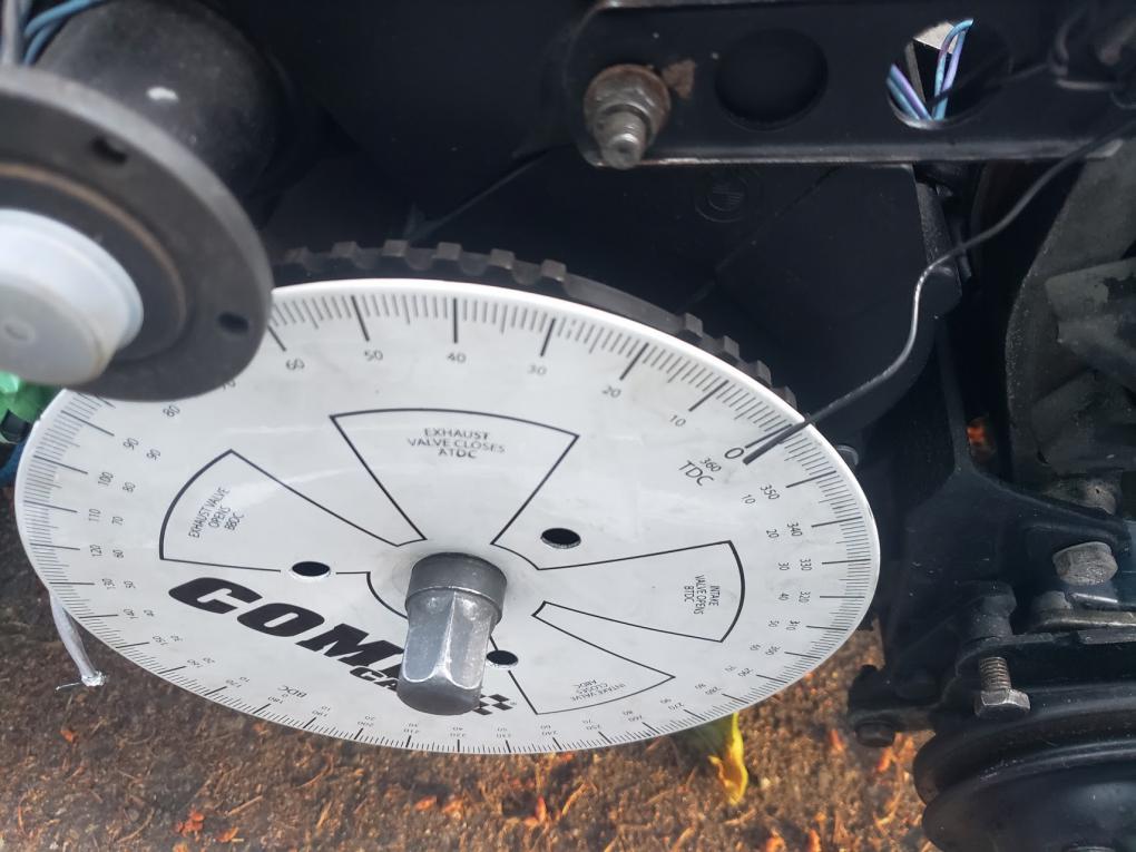

                        Finally got around to taking a stab at degreeing my cam.
                        Was having some issues getting the dial micrometer properly lined up, anyone have any recommendations where I should rest the pointer?
                        Further, I decided to quickly check duration (cam is supposed to be a 284/280). Just a rough check, knowing my micrometer probably wasn't perfectly positioned, I was getting 245 degrees or so valve open on the exhaust and 315 on the intake.
                        Ok, what the fuck?
                        Oh...
                        Don't bend the shit out of your degree wheel, kids.
                        So anyway, I have yet to degree the cam.

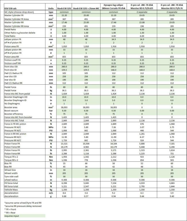

                          you sure at 100lb you are over 1100psi?
                          i couldnt upoad the XLS file but here is the next best thing. i need to check the FR vs RR circuit pressures
                          unsure if the pressures are just force / total FR + RR MC areas meaning the pressure will be the same in both circuits and hence the bias is only adjusted with the adjustable bias lever not MC piston size but i do not believe this is the case. My calulations use the ratio of areas to work out the pressure in each FR and RR line

                              #104
                              MC piston size will definitely affect bias. Even if you kept a 50/50 setting on the balance bar, at 100lbf on the pedal and say a 6x ratio you would have 300lb on each master. Different sizes will then give you different pressures for each circuit. I think that normally with smaller rear piston areas you would likely want a smaller rear MC by a bit to even out the braking force you would be getting from the rear wheels (higher system pressure from a smaller MC will translate into higher braking force). All that said, I am not sure exactly how pedal travel comes into play. I guess ideally one would match front and rear MCs to produce equal braking force then tune bias with balance bar.
                              yeah the force in the MC should be split equally if the balance bar is adjusted 50/50. ive corrected a few logic errors and added some vehicle weight distrubution and weight transfer
                              here are my revised calcs
                              what it says is assuming i didnt balls it up Click image for larger version  Name:	E30_Braking.png Views:	0 Size:	405.8 KB ID:	9929290
                              - from a force and bias point of view that stock brakes without the rear delay valve has to much rear braking for the tyres
                              - 735i mkaes the pedal very hard
                              - 735i 25mm MC swap has the same bias and braking forces as the Massive booster delete setup with his 280mm street kit with 0.700/0.625 MC. the pedal travel will differ though.
                              - 0.75/0.700 has the best bias % when weight transfer is considered assuming the pad compund front and rear are the same (probably arent)

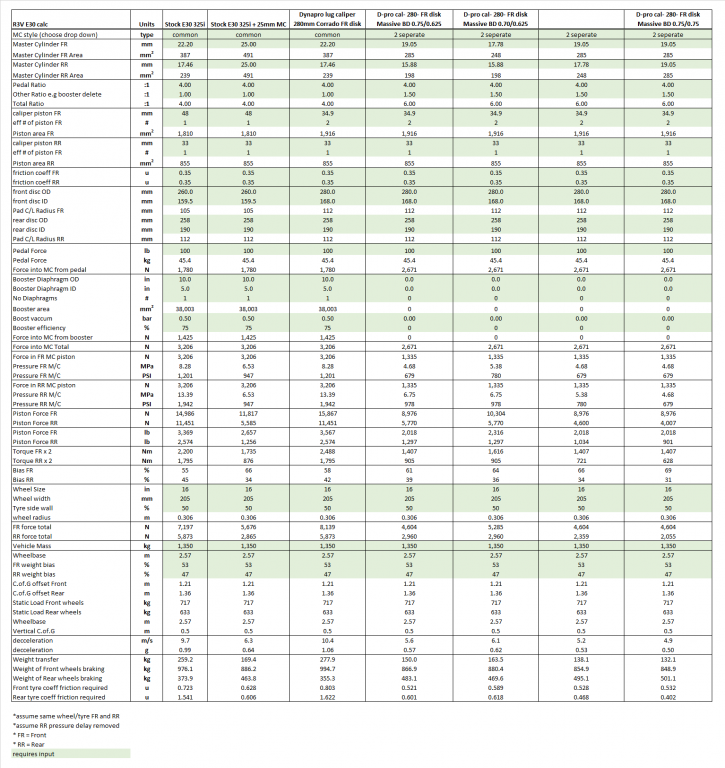

                                #105
                                I need to make up my mind on whether to go with 0.7/0.625 F/R masters or 0.625 for both, with the stock brakes. I am leaning to 0.625 for both and making a significant adjustment with balance bar. This is just for street use while I get everything working with the motor build.
                                Do you think I will be irrecoverably ruining the brake balance if I run twin 0.625s and bias a fair bit using the balance bar? Even if it isn't great balance wise fronts should still lock first, and I can likely use a 6.1 pedal ratio as well so hopefully travel isn't abysmal. Really at this point I just need something drivable until I can figure out suspension, wheels and brakes.
                                In other news, hopefully getting the car back on the lift this weekend, things should then be moving pretty quick.
