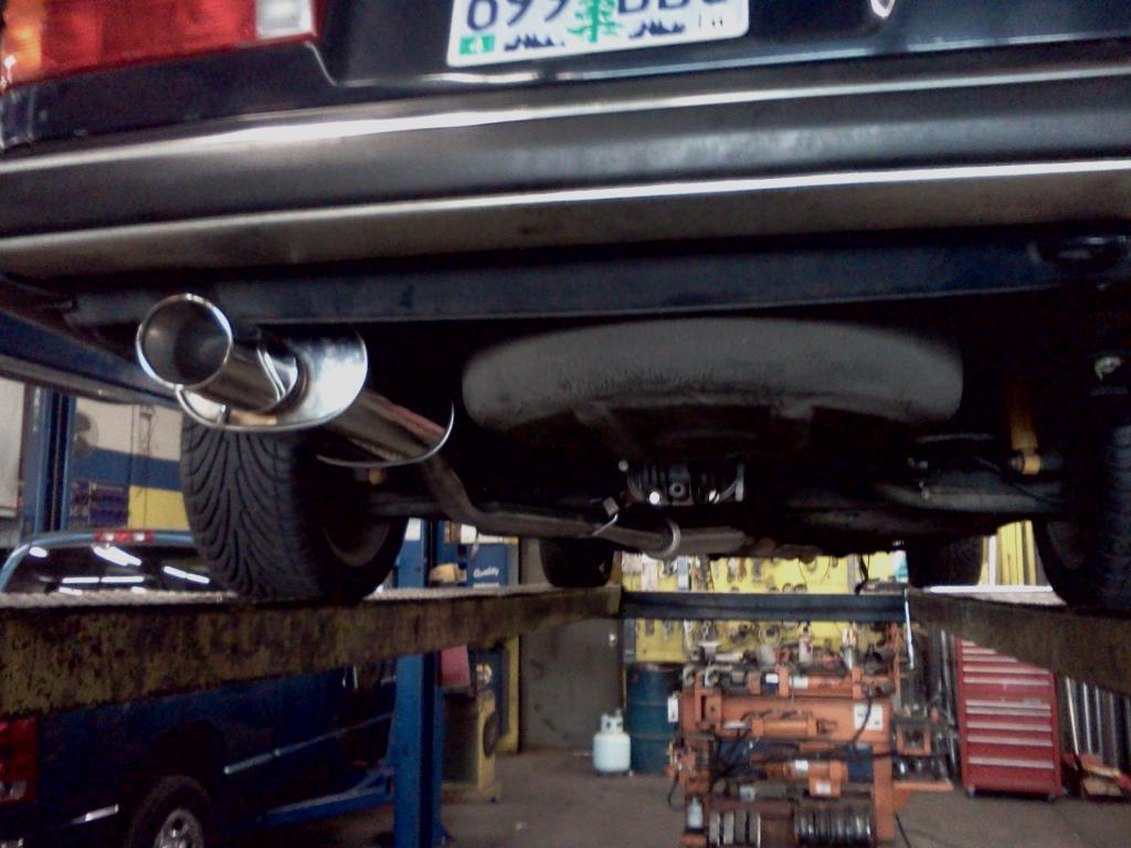

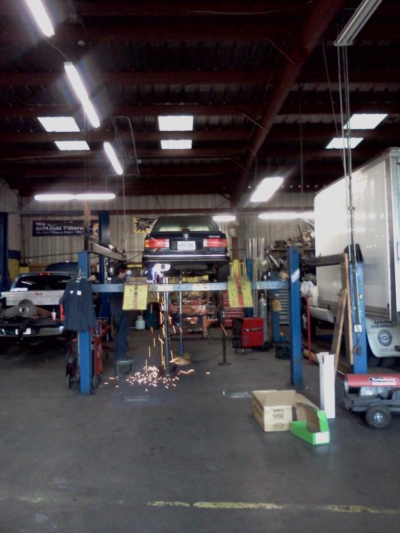

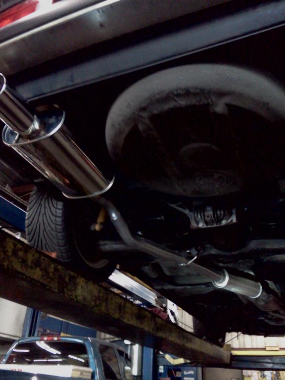

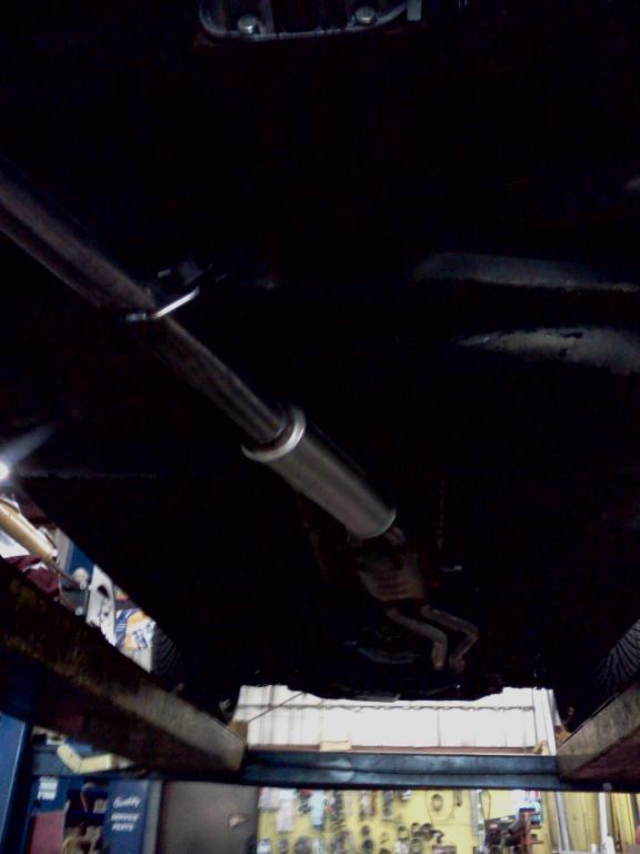

              M30 exhaust finished
              Some pictures of the exhaust installed today. I forgot my camera so cell phone pictures will have to do. Electric fan works so swap is DONE
Name:	Muffler installation1.jpg
Name:	Muffler and resonator.jpg
Name:	Muffler shot 2.jpg

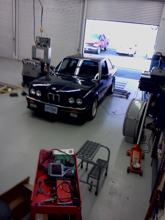

                        M30 swap is California smog legal now!
                        Yes!! The car passed the BAR referee inspection. It took 2 1/2 hours but I got the sticker. Two hours of the inspection was spent by the referee looking for information that specifies that the engine is 3.5 liters not 3.4 go figure. I think he just gave up and figured out BMW rounded up the numbers (which I tried to explain) But anyway it passed. :D
Name:	Bar inspection.jpg
Name:	Car at the BAR referee.jpg
