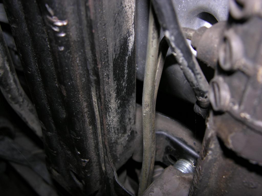

                #142
                updates please.
                can you take pics of how close the pan sits to the subframe?

                  #143
                  Originally posted by bataangpinoy
                  updates please.
                  I'll post some pictures tomorrow. I'm trying to fit the wiring harness in the engine bay.

                    #144
                    updates please.
                    Here's a picture. Not the best but hopefully it gives you an idea. There is a gap about 1/2"-3/4".

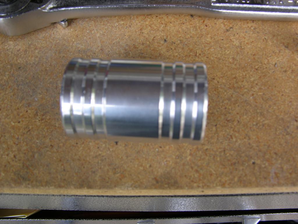

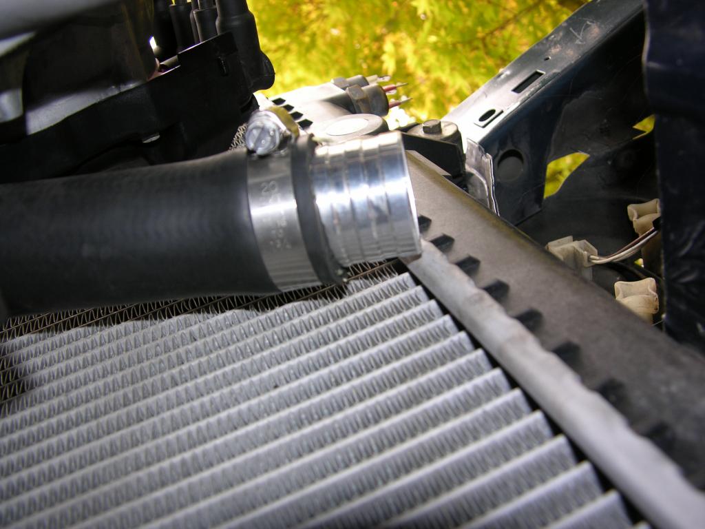

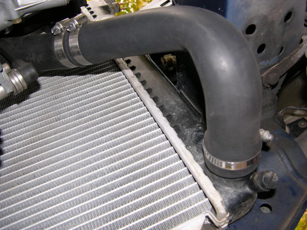

                      #145
                      M30 swap lower radiator hose too short?
                      My lower radiator hose was too short so here's what I did. I used two M30 lower radiator hoses, a 38 mm OD fitting purchased from Pegasus Racing, and two clamps. I tried it with one hose cutting it in half with the fitting in the middle and it was still too short. So installed the first half, then the fitting, took some measurements with the second hose, a cut and finally got it right.
Name:	fitting one end.jpg
Name:	fitting installed.jpg

                        ^that looks great. I had the same problem with my lower rad hose but my solution isn't nearly as elegant.

                            #148
                            [ATTACH]32615[/ATTACH]
                            [ATTACH]32616[/ATTACH]
                            [ATTACH]32617[/ATTACH]
                            Why did you not just use a e28 m30 rad hose ??? It fit's perfect. You now have another join and possible weak point the water system.

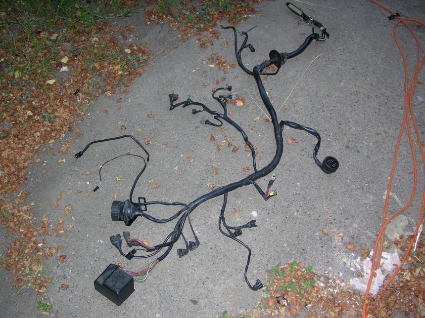

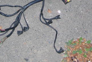

                                #150
                                Wiring questions E30 harness
                                I am using the E30 harness and I have a few questions.
Name:	E30 harness.jpg
                                Is there a way to find which of the 3 prong connectors go where. There are four of those connectors.
Name:	E30 3prong connectors.jpg
                                Did you cut the e30 oil level connector and splice in the M30 connector. From the C101 I was able to find oil level static and oil level dynamic.
                                The single wire with a connector at the end is for the coolant level sender in the coolant tank? If so what did you do? The sender has two prongs.
