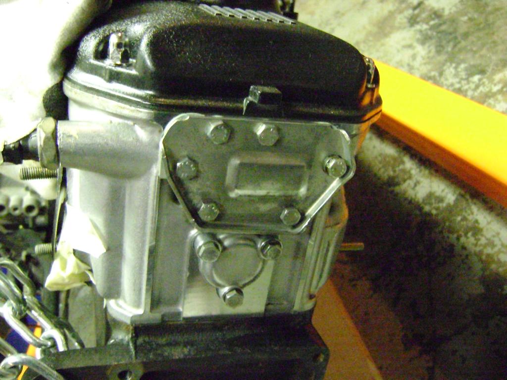

          Some more progress. Replaced the gaskets for these covers Click image for larger version

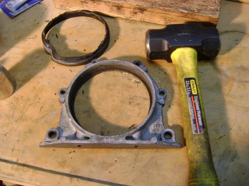

            Removed the rear main seal from the holder. My BFH had to lend a hand.

              #36
              make sure that you tap the new one in a mm or two farther than the last one to prevent leaks...

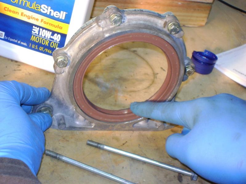

              • 1987E30project
                • Dec 2006
                • 432
                #37
                Here's the new one installed. I went 2mm below to avoid leaks. Put a little oil on the lip so it slides in easy when installing.

                  Some more progress. Replaced the gaskets for these covers [ATTACH]25891[/ATTACH]
                  Does anyone else think that gasket looks like a duck? Quack quack!
                  Looking good :)

                    Sure does. Ummmm..... I didn't use new washers when replacing that gasket. There was only one screw using a washer also.

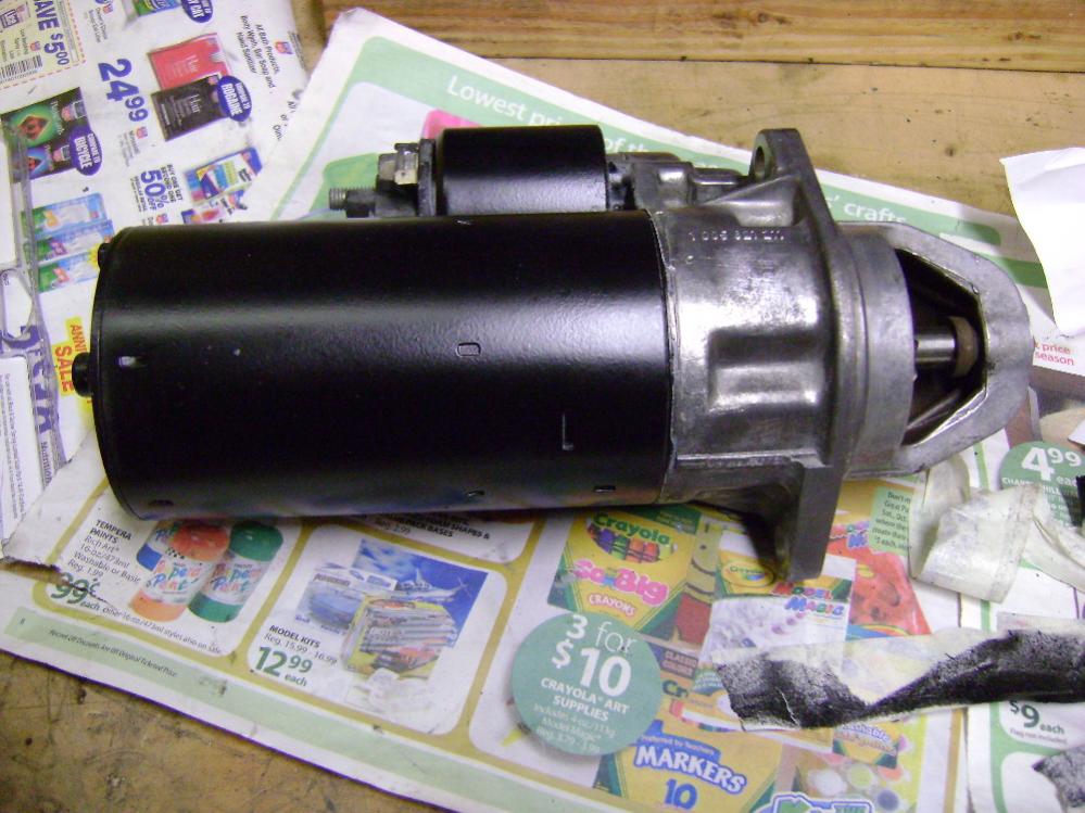

                        Update
                        I had the starter tested and it passed and since the paint was chipping i gave it a coat of paint.

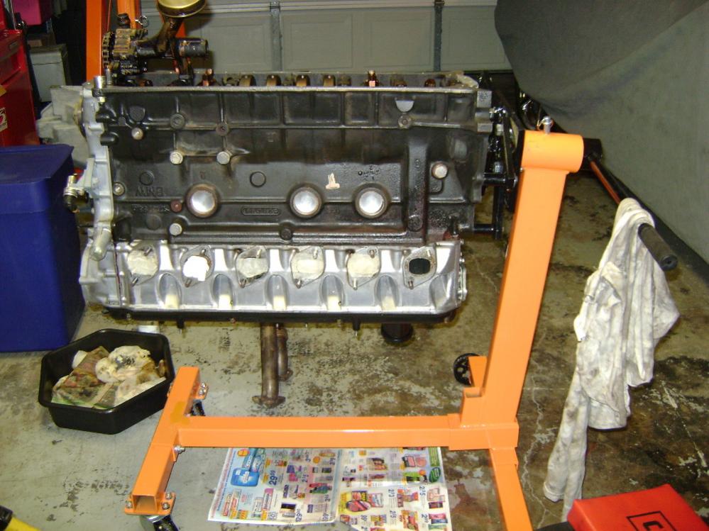

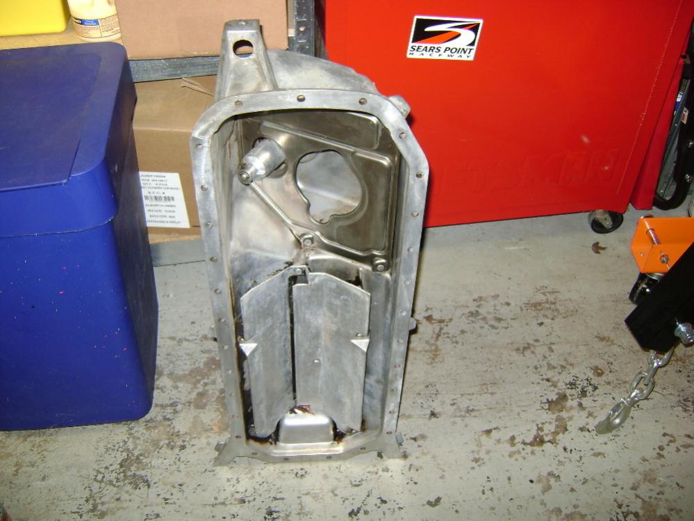

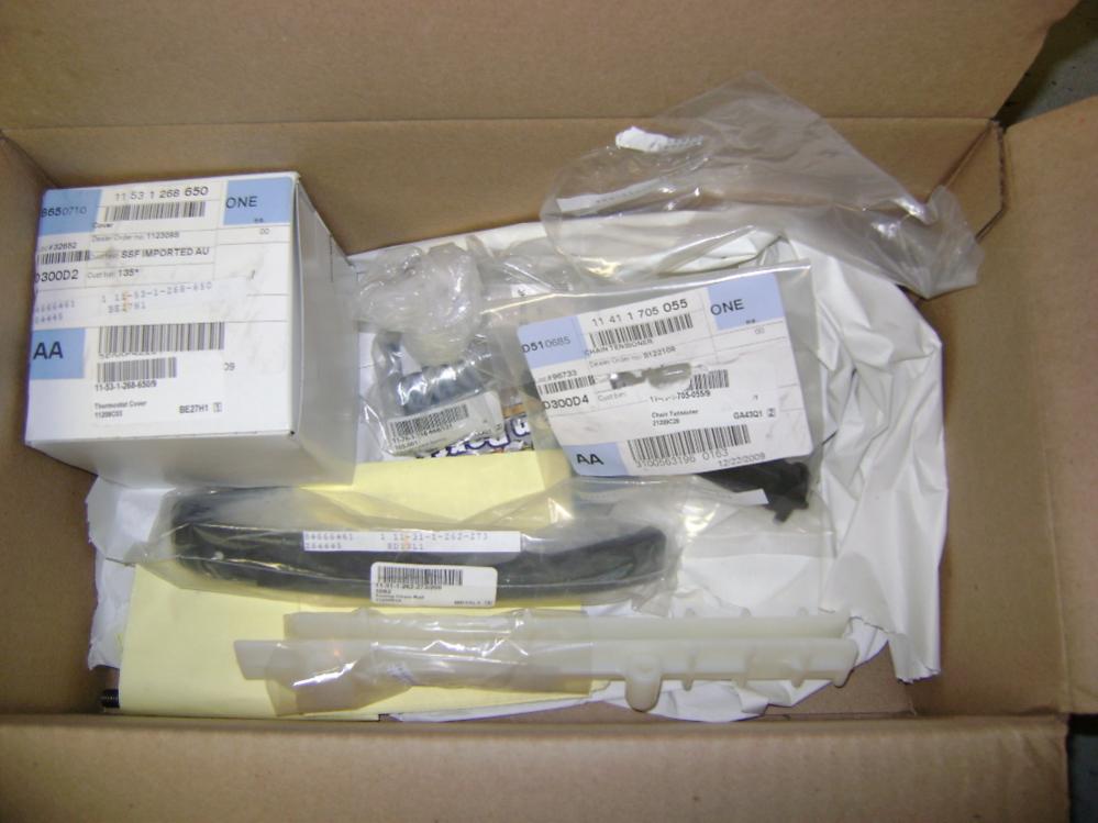

                        Removed and cleaned oil pan. Engine waiting for some parts which just arrived.Click image for larger version
                        Now I have to figure out a way to remove the crankshaft nut and replace the chain guides and tensioners.

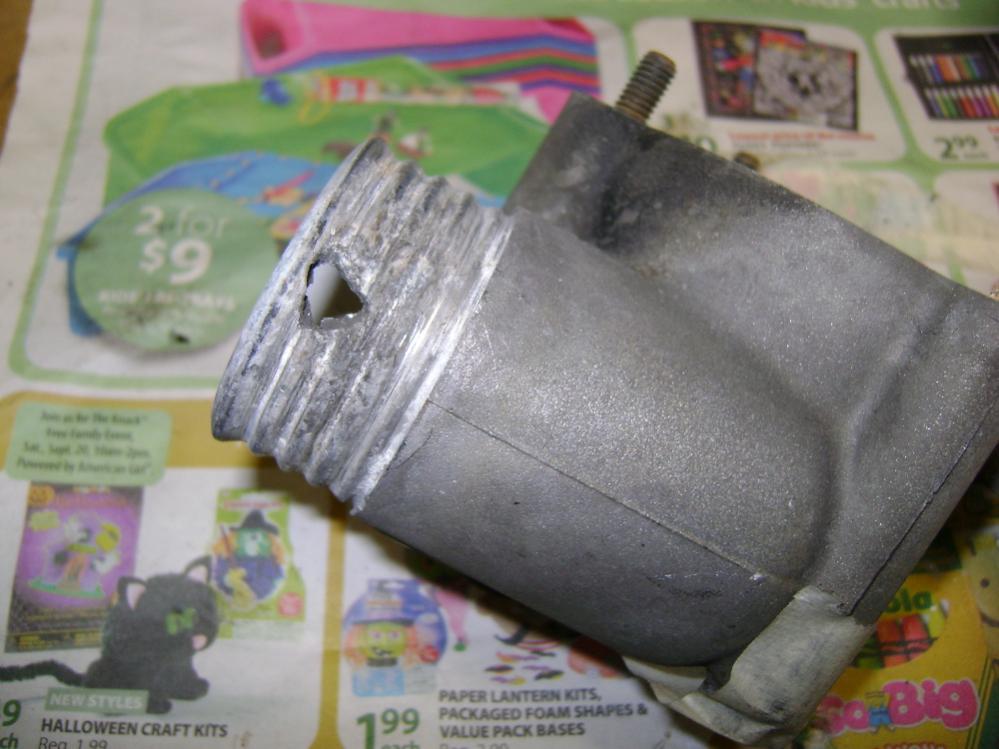

                        I think this makes a good argument to use BMW coolant only. Would you reuse this thermostat cover??

                          #42
                          [ATTACH]26545[/ATTACH]
                          Yeah, use bmw coolant.
                          If funds were a bit tight, I'd reuse that thermostat cover and just put the hose clamp up further. Double check to make sure there isn't any damage elsewhere too!

                            #43
                            [ATTACH]26543[/ATTACH]
                            ahhh! your motor is upside down!

                              #44
                              I'm replacing the water pump, thermostat, what else should I check or replace?

                                #45
                                Whoa! What the hell caused that?
