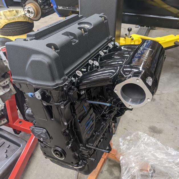

                    Waiting for the weather to warm up, but the new engine is looking pretty
