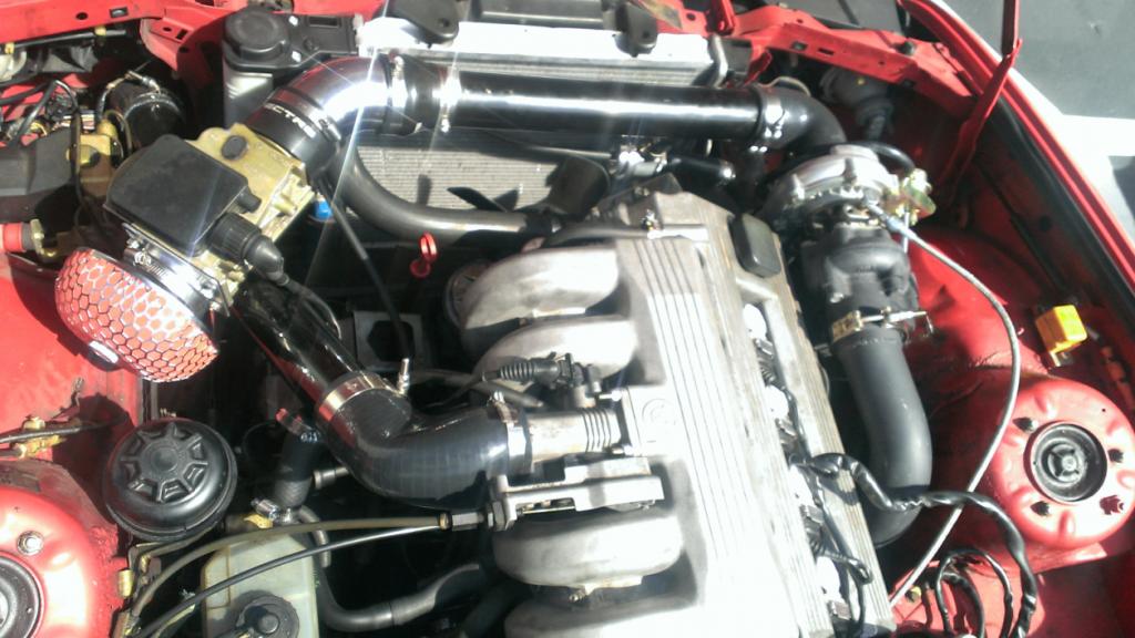

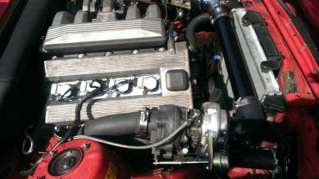

            #290
            Pictures!

                              #299
                              Awesome pictures, very clean install. Whats your feelings on the 3 foot long intake across the engine bay?
                              • BimmerJones
                                • Aug 2013
                                • 30
                                #300
                                I don't mind it, there isn't really any other place for the afm to go, if you don't want it to see boost, and it keeps you from having to lengthen the wires for the plug to it. Once I end up going standalone I will delete it.
