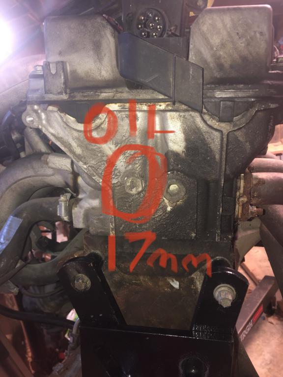

              • Super_e30
                • Nov 2019
                • 1
                For future readers, here is the bolt on the back of the m42 that you can run oil pressure, or an oil feed from.
