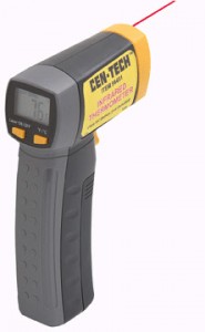

      Must have tool. $30 at harbor freight

        I have a one of those thermometer guns - where would I take a reading from?

        The only other thing I can think of is an incorrect thermostat, I'll check the temp with the gun and report back
