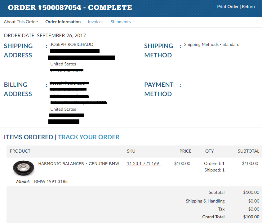

                      • jrobie79
                        • Mar 2006
                        • 2526
                        $100, where? Show me a link, all I see is standard pricing.
                        ouch, I just checked their website. it skyrocketed up to $520...that SUCKS.
                        Below is my receipt, you can see the price I paid and the date...sorry guys

                        • roguetoaster
                          Biggus Tippus
                          • 7830
                          Wow, what a deal! Must have been an F up on their end.
                          If I saw it at $100 I would have picked up 3.
