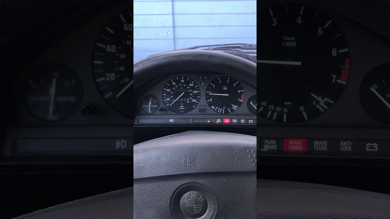

          update:i believe i got the code 1222: Lambda Control System Bank 1:The ECM has been unable to maintain Lambda (fuel mixture or fuel trim) on Bank 1 (cylinders 1–3) of engine. Posted another youtube link for any other code breakers who want to double check my work.

            The code flashing is correct, as stated above start with the crank sensor and inspect/wiggle the trigger wheel. The best way to check for a clocked damper is to rotate the engine to see if it shows that timing is correct via the oil filter mark/hash on the trigger wheel and that a screwdriver or similar fits in the flywheel lock hole as well. If they don't agree and you can see both cyl 1 cam lobes pointed up and at each other it's a safe bet that the damper has rotated.

              Aren’t codes 1243/1244 related to the sensor being faulty? suppose it wouldn’t hurt to try though. this user over on m42 club has the exact same symptoms as I do but yet the thread led to a dead end.

                Codes can also be a symptom and not a causation, so don't think of them as gospel, more as a guide.
