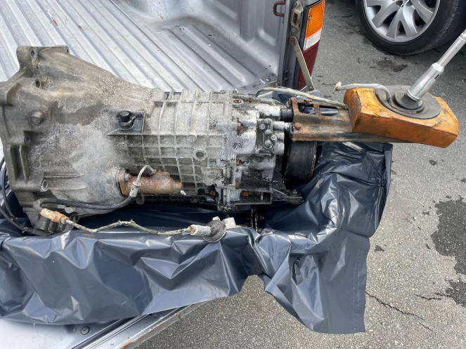

    *89 325is Auto to Manual Conversion
    Hi everyone, Hoping to get some help from anyone about my conversion. I got a older model Getrag 260 with a metal shifter plate not the aluminum shifter carrier. Anyone know how to mount rear part of the the metal shifter plate to the tunnel or any bracket that I can mount to the transmission so I can use the newer style aluminum shifter? Any info or comment is really appreciated. Thank You

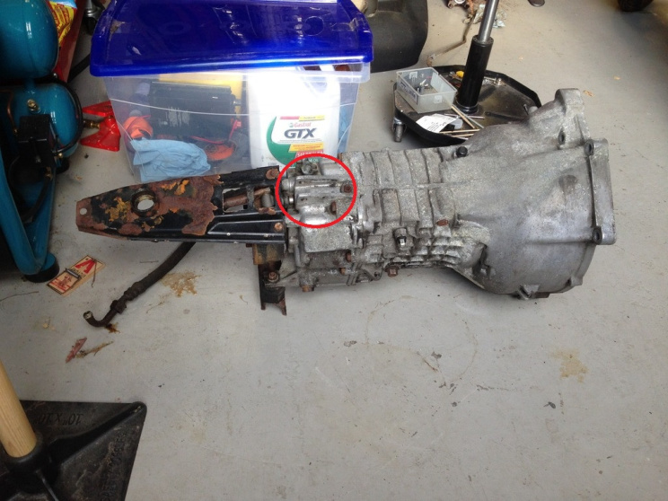

      Here is my G260 with the plate style carrier. If you have the mounting ears (circled in red), you can convert to the newer style carrier.
      Also note that you'll need some short bolts (16mm?) for blocking off the old plate style shift carrier mounting spots (installed with Curil K2 or other thread sealant.)

        Unfortunately the one i got doesnt have the bunny ears to mount the later style carrier.

          I guess your other option is to go with a Chassis mount shifter.
          I have a CRS in my car that I like, but it wasn't a bolt-on affair. Needed some customization to work how I wanted.
            Yeah, I guess I have to go with chassis mounted option also. How are they as far as vibration? I heard you get a lot of vibration since you have to also change your trans and engine mount with harder ones.
              I am using OEM rubber mounts for both engine (E28 for 24v swap) and trans (ZF320) without issue with the CRS shifter. No added NVH in my case.
              Can't speak to other chassis-mount designs as to whether they require stiffer mounts.
